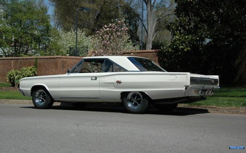

I found two pictures that I think are original'ish. Gold car looks good from drivers door back.

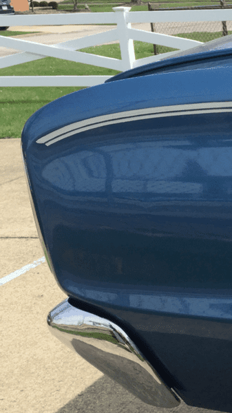

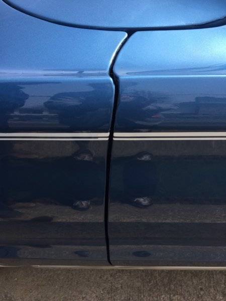

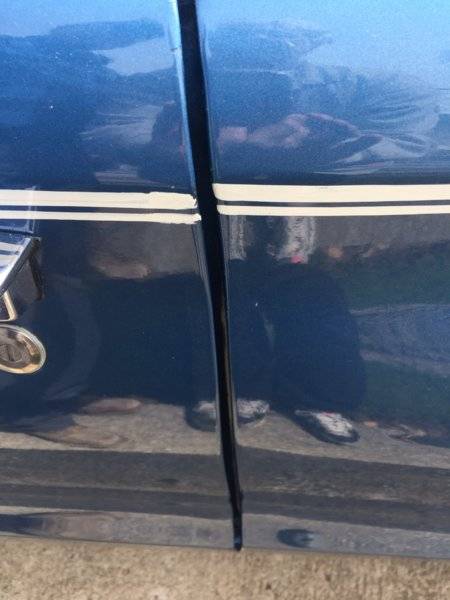

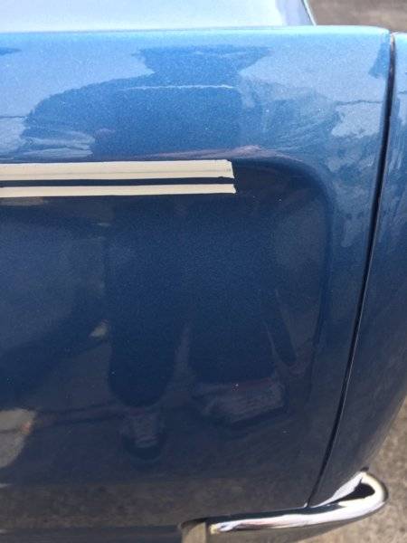

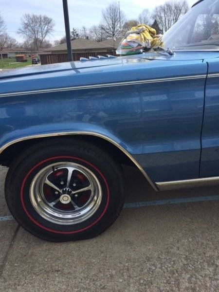

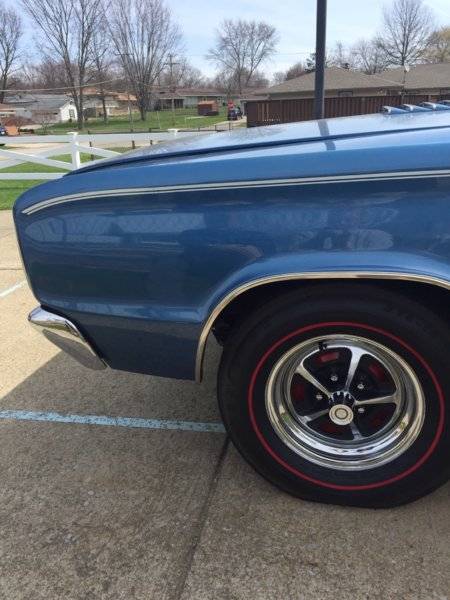

Greetings: I have taken pictures of my Original 67 Coronet R/t white pinstripe. I took closeups of the tip of the front fender, the front fender and the front door and back of door to the rear fender and the end near the fender extension. Stripe is white. I need your e mail so that I can send the pictures fron my wife's phone. I will await your reply. THANKS!

Also I believe the top strip is 1/4 inch separated by 1/16th ich and bottom stripe is 1/8th. Hope I am measuring it proerly. Let me know.

Pictures delivered. Thank you John! Great looking car.
I would agree with your dimensions. 1/4">1/16" space>1/8" lower.

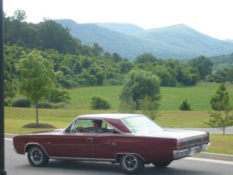

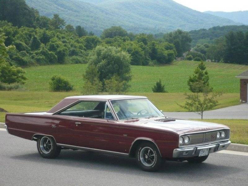

My 67 R/T was an original car when I bought it, and I tried to exactly duplicate the stripes when I repainted it. However, I did that in 1988, and do not remember exactly how they terminated. My car has only the upper belt line pin stripes, and I don't think I have ever seen an original car that had the lower pin stripes. (And have definitely never seen the "rallye style" stripe except in that ad. I can take pics one day when I get it out from under the car cover. Pictures from a distance do not really show the stripe, as my car is the dark red and the stripes are black.

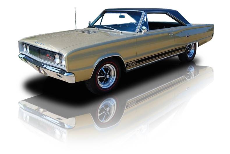

These are the only two examples I could find. I have never personally seen one in the flesh with a rocker stripe applied. Some how I doubt that they were a popular item.
View attachment 581979 View attachment 581980 It appears to be about 2 inches above the rocker trim and terminates at the wheel well chrome trim about a 1/8th of an inch off both edges in line with the trim curve.

I am a 1967 R/T guy, and I have had my car 35 years. In all that time, I have never seen an R/T with the lower Rally stripe in the flesh. I think it was likely a dealer applied option. I do not believe there is a factory option code for it. I find old original road tests in magazines like Car Life, Motor Trend, Super Stock are great references for how cars were actually built. Sometimes there are great details to be seen. One magazine of the era actually had a drive test on a 67 Coronet 500 ( not R/T ) with a 426 Hemi automatic. A local graphics place could likely reproduce that lower stripe from a good photo or magazine ad from the time.

I had forgotten about this thread. Here is a more recent picture.
I am an original 67 Dodge Coronet R/T owner purchasing the car 02-24-67. I had posted pictures of my 881 blue 67 with white pinstripes and correct measurements for the stripes April 22, 2018. There were no bottom stripes from Dodge other than pictures in brochure. Visited production site in Detroit several times neve saw one. Have seen a few at Mopar nats Columbus, ohio that were put on by owners. Hope this helps.
