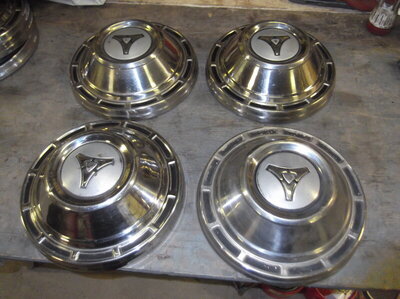

I can't figure out if an R/T could have had hubcaps or the 10" dog dish.
I found an old dealer brochure, here's what is says:
- Coronet Base - Stainless Hubcap (Coronet 500 deluxe wheel cover standard), I assume this is the 10" 'dog dish' with color coded wheel?

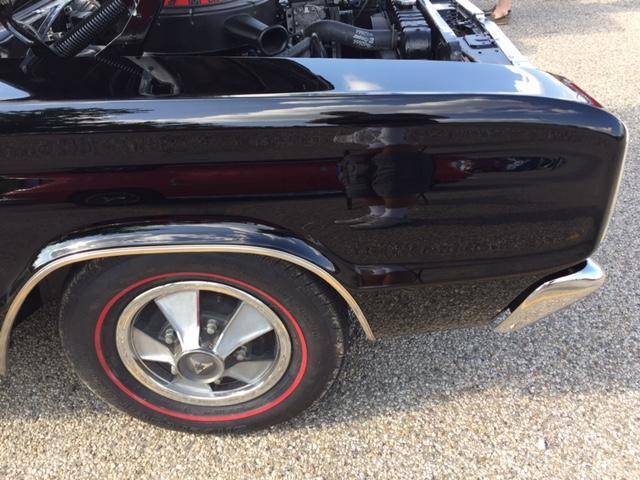

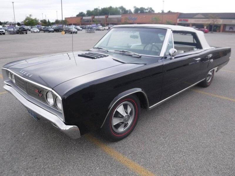

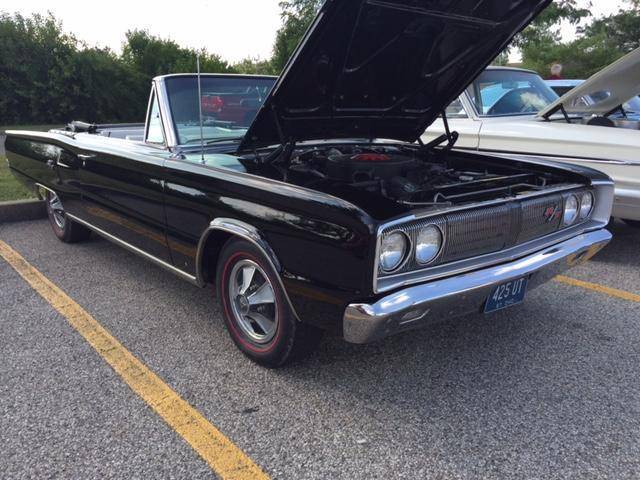

Wow, it sure does show those dog dishes...and on a convertible even.
I was pretty sure upscale models like Charger, 500 and R/T would have had a less "economy" cover as standard.
Back in the day, if someone ordered a car and knew they were going to mount aftermarket rims, they went with the standard rims and the small "dog dish" caps because they were included in the price of the car. When I bought my '67 R/T, it came with a set of the optional Mag Wheel covers. One of the covers had one of the decorative die cast "wheel nuts" twisted off. Apparently some one had a flat tire, and did not realize these were just covers.
If you don’t choose any option wheel covers you get body color wheels with these caps. This is the only way to get body color wheels. Any full wheel cover gets black wheels.
R/T and GTX don’t get full wheel covers as standard equipment but the Coronet 500 and Satellite do.

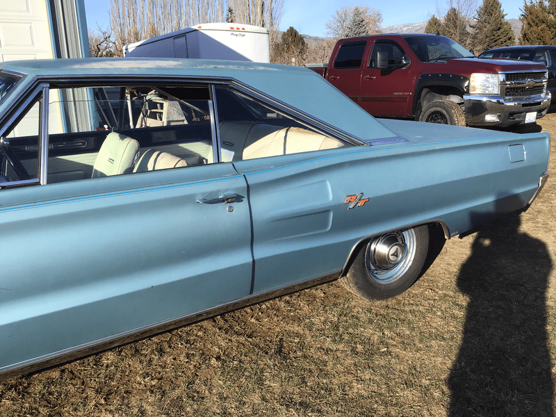

I know the brother of the original owner of my 67 R/T. We were talking a few years ago, and I asked him what came on the car new. He said it was the full wheel cover as in Post#11 above. His brother wanted Magnum 500s, but bought them from a local distributor cheaper than what Chrysler charged for them. So my car got "aftermarket" magnums when it was brand new. But it came from Mopar with the full covers.
Here is a photo of my R/T from the original owners daughter
