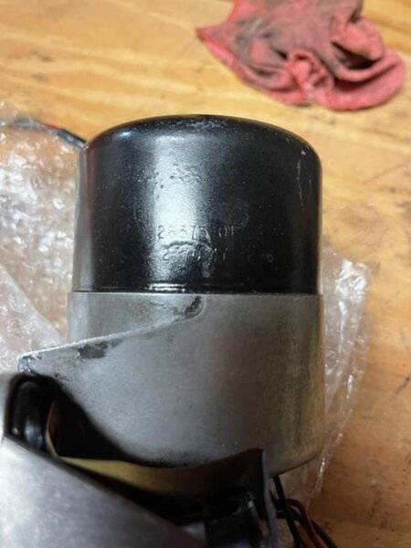

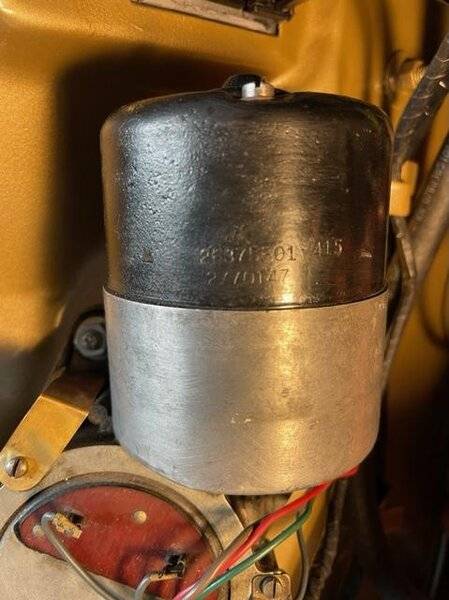

I have two wiper motors, #26375-01 and #26375-01 that each have a set of sub-numbers, see attached photos. Not sure what they belong to, as neither one is on Kim's list on her website. I installed each one today but my air cleaner cover doesn't fit because it is hitting the wiper motor. The air cleaner base fits with the filter but not the cover.

wioer motor # 26375-01  415  2770147.jpg Wiper motor #26375-01  415  277047296.jpg

Both wiper motors were in a box of parts when I bought the car. No I do not have the broadcast sheet or window sticker. When I researched before buying the car was registered with Galen Govier by Cecil Higginbotham out of the Ocala, Florida. I spoke with Galen and he confirmed. I haven't operated the wipers yet as I just put the engine back into the car after I did all the new wiring, painting etc. I didn't realize the air cleaner wouldn't go on until today. I tried to install today and the base fits with the air filter but the hemi air cleaner cover will not fit with the wiper motors I have. I will measure the linkage, which is in the car. I removed my gauge cluster today and will measure. Thanks.
Strange because the aircleaner should fit around either wiper motor.

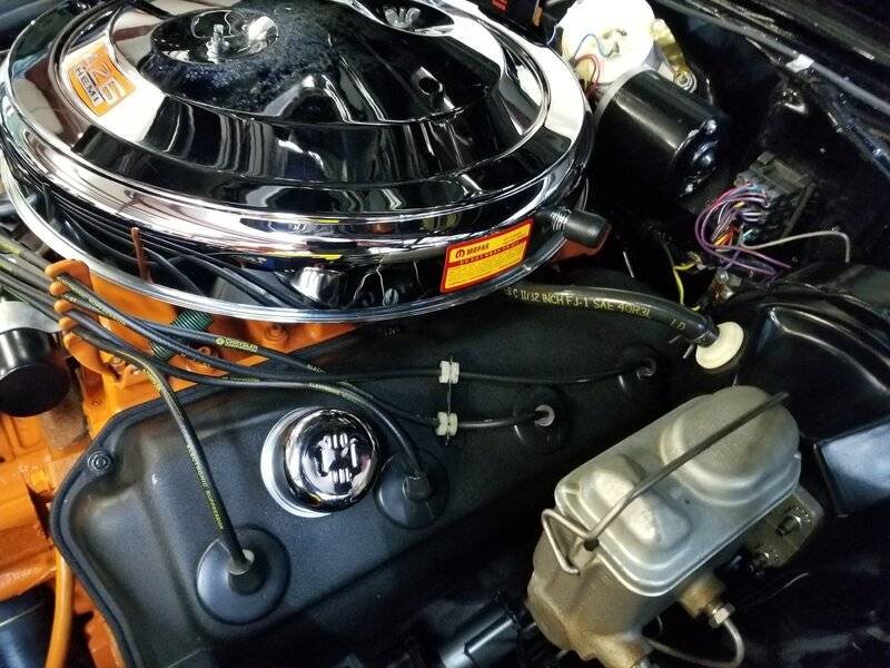

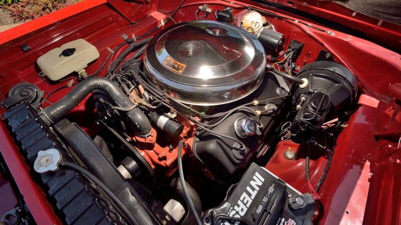

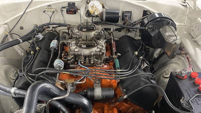

2 speeds shown here. Your motors look like 1966 motors. Look how the black and aluminum are equal size on yours, but not on these 67’s.
The part number in the book and the casting number on the part are not always the same.

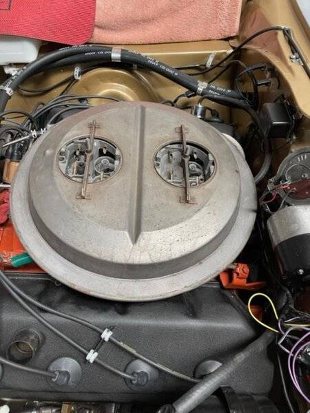

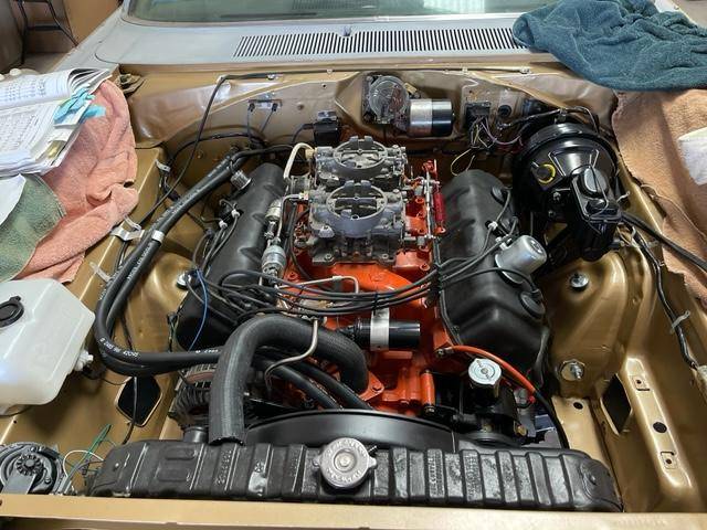

Yeah I thought it would fit and never gave it a thought until today. I went to install my air cleaner and the lid won't drop down over the base, it is just hitting the wiper motor bracket that holds the wires in.

As posted many times, the switch will tell you what motor you need, 4 wire motor variable, not sure if the 3 speed is the same. 3 wire motor is 2 speed. All of this is what I have read. Our variable speed has 4 wires. The Topher Knows!!
Here is the 2 speed.
Those motors Dean has look bigger in diameter.
Well, I have a few original motors on 66-7cars. My case is black. One 67 is part black, and have seen gold. I have 1 possibly 2 original 67’s with everything intact. Some motors are also shorter. Where there different suppliers? Don’t know.

Kim responded and told me that they are two manufacturers: Leave Neville or General Industries. The 2 speed wiper motor is identified with 3 wires to the bulkhead connector and 4 wires for the variable speed motor. I believe I have 4 wires to my bulkhead, I will check. The photo that Jerry Hall posted looks like the round case is thinner than mine, which is why it is the correct wiper motor. Thanks to all of you, just need to find the correct wiper motor. I will follow up with what I find, thanks to all of you.
