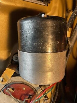

Good afternoon, I have a 67 Dodge Charger with a 426 Hemi that I am restoring. I bought the car as a project, engine out and most of the engine bay components were missing. I have assembled over the past year everything I need except a correct wiper motor. My parts book says it should be #2808 767 for a 2 speed and #2808 801 for the optional variable speed. How do I tell which one I need? Is there different wiring or design? Does anyone have a photo of either one of these wiper motors?
I've looked in my service manual and parts books and can't find a picture, drawing of what I need, I only have the part numbers. I have sent Kim @Passion4Mopars an email. I looked at her website but didn't see what one of these wiper motors looks like.
I have two wiper motors, #26375-01 and #26375-01 that each have a set of sub-numbers, see attached photos. Not sure what they belong to, as neither one is on Kim's list on her website. I installed each one today but my air cleaner cover doesn't fit because it is hitting the wiper motor. The air cleaner base fits with the filter but not the cover.

Both wiper motors were in a box of parts when I bought the car. No I do not have the broadcast sheet or window sticker. When I researched before buying the car was registered with Galen Govier by Cecil Higginbotham out of the Ocala, Florida. I spoke with Galen and he confirmed. I haven't operated the wipers yet as I just put the engine back into the car after I did all the new wiring, painting etc. I didn't realize the air cleaner wouldn't go on until today. I tried to install today and the base fits with the air filter but the hemi air cleaner cover will not fit with the wiper motors I have. I will measure the linkage, which is in the car. I removed my gauge cluster today and will measure. Thanks.
Strange because the aircleaner should fit around either wiper motor.
2 speeds shown here. Your motors look like 1966 motors. Look how the black and aluminum are equal size on yours, but not on these 67’s.
The part number in the book and the casting number on the part are not always the same.
Quick and easy to end this mystery by turning the switch on the dash. That will tell the story.

As posted many times, the switch will tell you what motor you need, 4 wire motor variable, not sure if the 3 speed is the same. 3 wire motor is 2 speed. All of this is what I have read. Our variable speed has 4 wires. The Topher Knows!!
Those motors Dean has look bigger in diameter.
Well, I have a few original motors on 66-7cars. My case is black. One 67 is part black, and have seen gold. I have 1 possibly 2 original 67’s with everything intact. Some motors are also shorter. Where there different suppliers? Don’t know.

Kim responded and told me that they are two manufacturers: Leave Neville or General Industries. The 2 speed wiper motor is identified with 3 wires to the bulkhead connector and 4 wires for the variable speed motor. I believe I have 4 wires to my bulkhead, I will check. The photo that Jerry Hall posted looks like the round case is thinner than mine, which is why it is the correct wiper motor. Thanks to all of you, just need to find the correct wiper motor. I will follow up with what I find, thanks to all of you.
According to Kim there are two suppliers, Leave Neville and General Industries, she didn't have a photo to attach but said she would see if she could find a photo and send to me. Looks like Jerry Hall has the right motor. Thanks.
