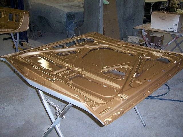

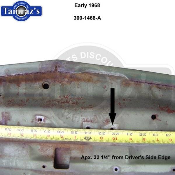

The "Scoops" will fit, but the frame under the hood skins are different. AND, They made an early and late
1968 Hood with two different locations for the hood latch. And the 69 hoods had the optional N-96 fresh
air options.
The Road Runner has I think a 68 hood. While the 69 scoops will fit it the hood doesn't have the same through holes in a couple locations.
I had to modify the hood to get the bolts/speed nuts to work.
Yeah - besides dimensions etc - They are just different hoods. Having a 68 X the 69's just a different look too.
