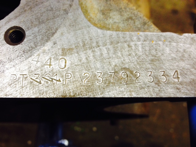

bought a 68 440 a couple years ago, in the process of building it now , when I got it I noticed there were no vin stamping near pan rail or by bellhousing, today I found this number and it looks like maybe a part number on the underside below the starter , does this number make sense to anyone? engine id.JPG

The PT=Trenton engine plant and than the human doing the stamping mistakenly thought he was working with a 361 for a minute. Not sure about the second P, may also be a mistake? 2379 is the date of assembly February 1, '68(there should be a VIN # on this block unless maybe it was a replacement). The last 4 digits are supposed to be a build sequence meaning 2334 engine built but I don't know how often they started back at 0001.

...Not sure about the second P, may also be a mistake?.....
P for Premium fuel.
The 2 1 assembly date should also be stamped on the pad in front of the valley pan.
IF the engine was an HP assembly, you should see an HP stamp on the pad also.

I thought it might be for premium fuel but figured that would only have been on the top pad. Thanks for the info!

The SPD is 911 so it was scheduled for build Sep 11, 1967. The motor would have been assembled up to a few months prior to that date.

Interesting info. I saw a block recently that had an 8 after the 440 where this one had a P. What would the 8 mean? Also on the id pad it has a C all by its self. Any idea on that one? Thanks.

bought a 68 440 a couple years ago, in the process of building it now , when I got it I noticed there were no vin stamping near pan rail or by bellhousing, today I found this number and it looks like maybe a part number on the underside below the starter , does this number make sense to anyone?View attachment 161040
