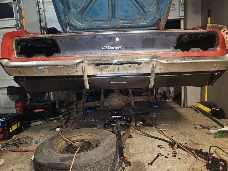

Yeai need to pull the rear passenger side rail down
try letting the suspension hang if you haven't already......jack it up an put jack stands under the spring hangers

I tried it with the leaf springs uninstall. I think I'm going to have to just drop the rear frame rail push the trunk pan down and see how things fit. If everything fits well. I'm just going to weld it all together. I can't waste anymore time on this

I just came back after a year break lol. Lowering the rear passenger side frame is the only option I can think of now. The driver side rear frame rail is original so I know if I can match the passenger up to it. It should be fine

I weld it. The passenger side rear frame rail was rotten when i bought the car so i replaced. Since the rear driver side has its original rail i could just match up the passenger side rail to it.
I have been messing this rear frame rail for a while and I can't figure why my rear passenger frame rail is higher than my driver side.

if you free the trunk pan from the wheel house on that side; it will allow you to pull the rail down pretty easy

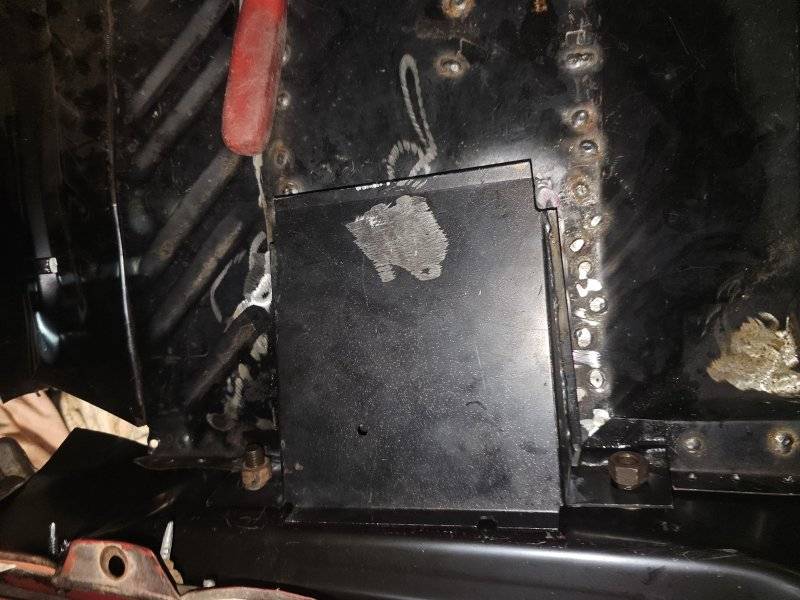

A lil update. So I basically did what
eldubb440 said. I took out the passenger side rear frame rail and drilled out the spot weld out of the inner wheel house. Once I did that I had all the play in floor pans. So I did what I was suppose to do from the getgo and mocked everything up before welding. Now I got those truck brace to fit and also pushed,pulled and kicked to get some of the other panels in placed. I should probably be welding it all up tomorrow.​

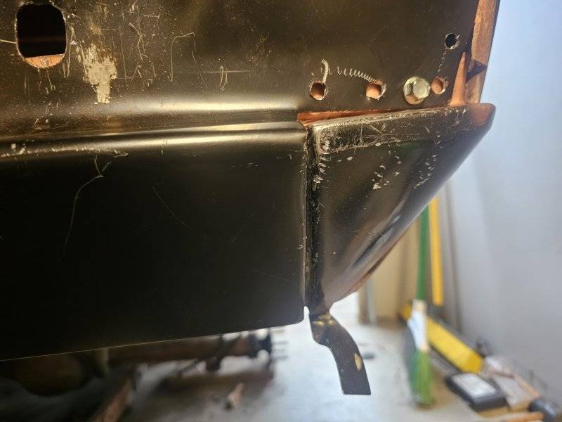

Hi guys and thanks again for the help. I wouldn't have fixed my error if it wasn't for yall. Just i need another favor can u guys send me pics of your quarter valance. I think my drive side one is a lil high
