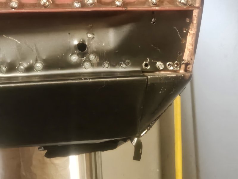

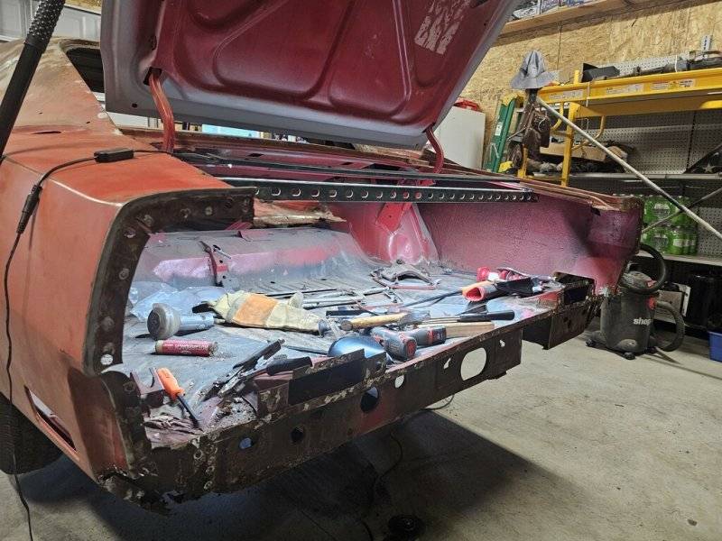

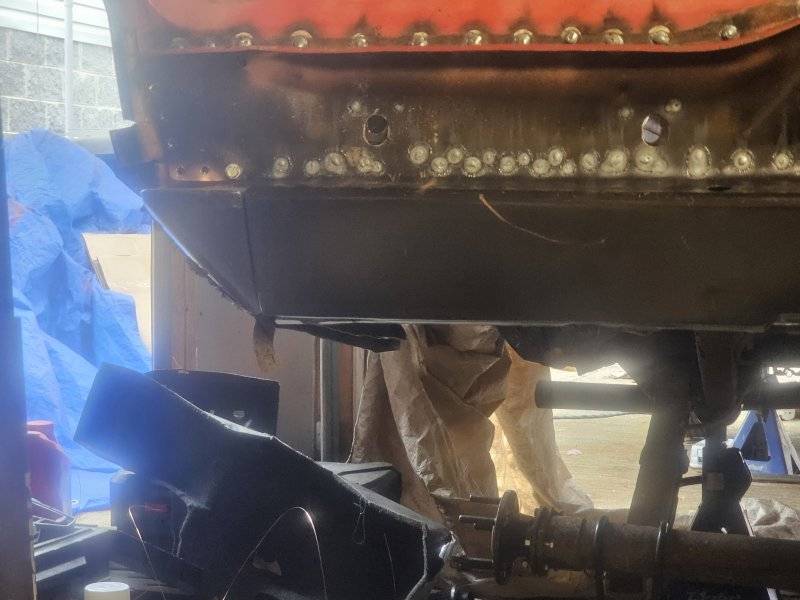

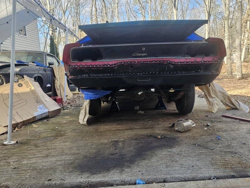

I have a quick question does the top of the trunk brace gets welded to the rear valance also?? I also fixed the quarter valance

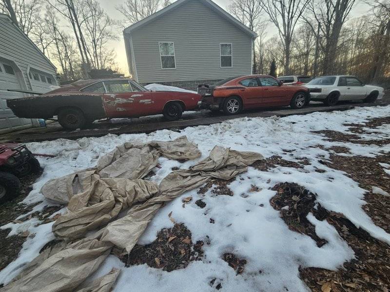

Im almost done with some of the body work with the charger. I want to drive my charger so I got a 06 daytona charger for cheap that I'm going to be doing a hemj swap into my 68 charger.
Glad you got it,never got 1 alert on this thread. Last year my buddy did mine. Thats why I said tac the corners before the tail light panel.

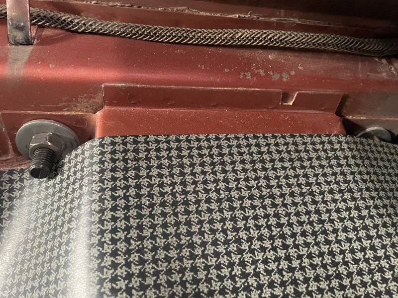

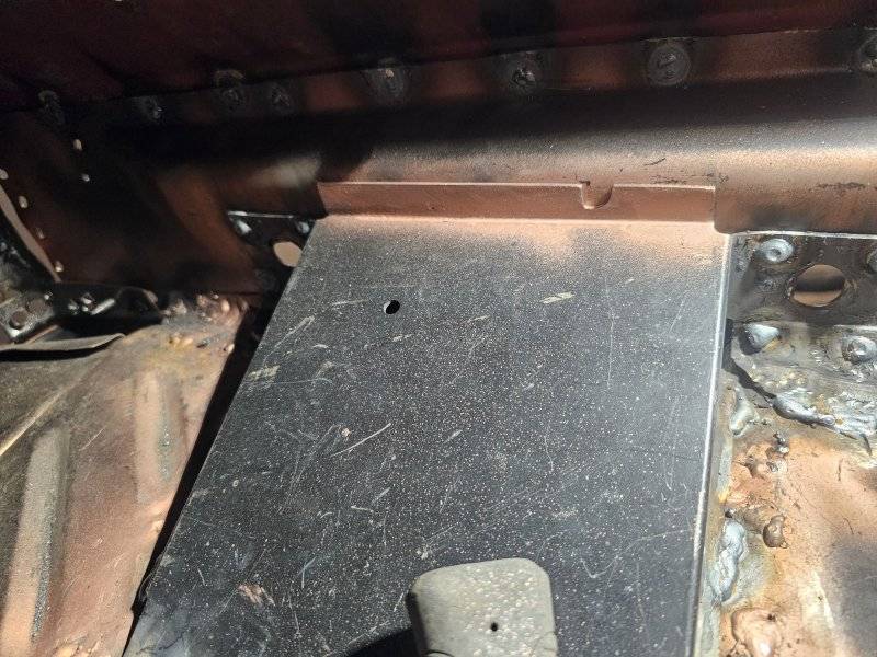

Hi I have a quick question. Is this panel body color or is it just paint blk?? It was on the bottom side of the driver side frame rail
Either black, natural, or undercoated. My car was Ziebarted back in day 1, so mine is covered in tar.
