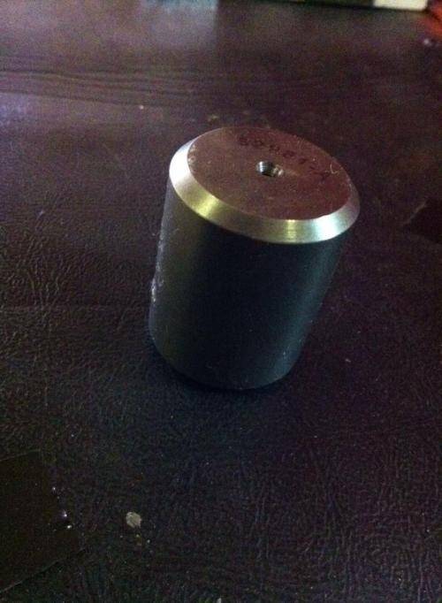

I found a photo
Yep. I bought a Eaton True-Trac third ember from Dr Diff. From his site it says
8.75" Eaton True-Trac fits all 8.75" castings all ratios and all stock axles.
"**When using stock adjustable wheel bearings, customer must insert differential thrust block (included) through the side gear splines before installing the third-member."
I found a photo
That looks like a solid spacer made for use with the True-Trac? If it is solid, it won't work in the stock 8 3/4 SureGrip carrier. This is what a stock one looks like....
This 2nd one is from an open carrier but it's very similar. It might even work in a SureGrip unit. Don't know since I never tried to interchange one.
The new third member replaced an open 741 case with 2.76 gears. That piece was broken in half lying in the bottom of the housing. Why they mated that rear end to a 440 is one of the many mysteries about this car.

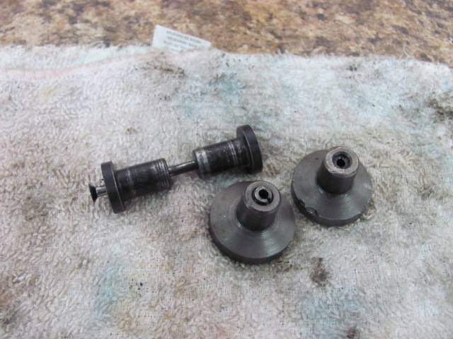

It's rare that those get broken and about the only thing short of total failure that would break one would be the axles were adjusted too tight or with 0 clearance or worse. Without proper axle clearance they will work the devil out of the center pin when the axles heat up and grow. The other type of thrust pin or buttons for the clutch type SG's will break apart pretty quickly with improper axle clearance where the one for the cone unit will take more abuse. I'm thinking someone must have tightened up the axle bearings much like you would the front wheel bearings and well, that'll kill either thrust pin pretty quickly lol.
Here's a couple of mine, the top one in the pic is from a clutch sure grip in a 741 case. The lower one in the pic is from a Detroit locker in a 489 case from Randy's Ring and Pinion. I installed green bearings 15+ years ago not knowing the thrust button would interfere.
There were a couple of times driving the car over the years I heard a loud "POP" from the rear, usually when making a turn. Years later, I was in process of putting that rear in a different car and when I pulled out the 3rd member, the thrust button came out in 2 pieces like you see in the pic.
