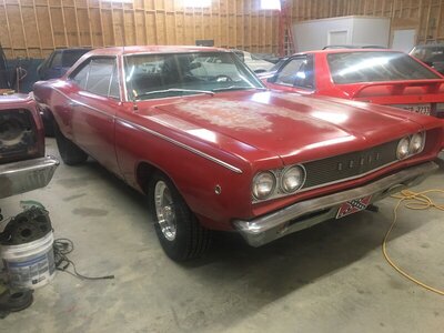

So I looked on my build sheet, the build code for the trans is 031 which according to the above post would mean the engine is the 330 hp version. I looked at the bottom rear of the engine, no HP stamp that I could see.
As far as the engine internals, the pistons are flat tops that are above the deck and I'm pretty confident they're original, the bore is standard. The previous owner told me he 'rebuilt' the engine (to what level I'm not sure) and used the "Roadrunner" 335 hp cam in it. I'll be honest, I'm not sure if I would have known the difference either way.
I changed the oil pan gasket recently and there's a double roller timing chain but looks like it could be a later addition. When I took the pan off, there was no windage tray though it has one now. The crank was not drilled for a 4 speed.
Not sure if the distributor was a dual point or not, the points and condenser were replaced with a Pertronix unit.
As stated previously, it had the HP exhaust manifolds, they're on my shelf. Also according to my build sheet my car was not equipped with dual exhaust or, at least there is no number underneath that option.
And again, my car has the 3.23 Sure Grip rear. I was stoked to see that when I first got it. The pinion seal and housing gasket leak but it's a Sure grip!

Numerous decoders show H as the 335 HP versions. Sometimes this accurate and sometimes it is not.
H in 68 only means 383-4 bbl. The same code was used in A,B, and C bodies. All versions have different HP ratings so the H does not tell you the rating. You have to look at the application.
For 1968 B bodies, the 335 horse version was only available in Road Runners and Super Bees with either transmission and without A/C. No other 68 B body got the 335 horse version. (69 and 70 are different). Meaning......no 68 Coronet 440s with the 335 horse version. It would come with a 330 horse version.
Depending on the plant and time of year, the VIN may be stamped on the back of the block near the oil sender. Check to see if the block is stamped and if the VIN matches your car.
If the VIN is not there, check the front pad for the engine assembly date and see how it matches your car’s Scheduled Production Date.

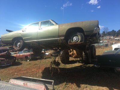

Had to buy the whole car to get a good trunk lid. She's been sitting in a junkyard for 20 years.
