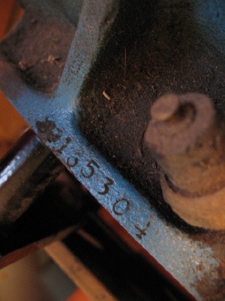

The vin on a `68 will not be on the machined pad down by the oil pan. If it is stamped it will be up top at the back adjacent to the mounting surface of the trans next to the oil pressure sending unit.

I went out and looked where you showed me in the pic but there are no numbers on the block the date on the block is 10-29-69 without a vin anywhere that I can find.Thanks

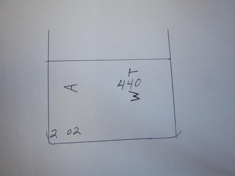

On the pad next to the dist. there is the numbers 440 and under those is the letter W but it is side ways and on the left of pad is an A under that iI uploaded a drawing of the pad. Thanks

That pad on the front should have a HP Stamped in it for high performance. GTX,s Had them.
The question is, though, did an engine block that was being used as a replacement under warranty in a GTX have an HP stamped on it?

I think the HP blocks were the same as the others, but had the Magnum cam, and 906 heads with heavier valve springs. You might google 440 magnum engine, and they give alot info on blocks etc. Seems like the letter on the I D pad indicates the year built? On my 440 says 7 T 440 H P E. Which means built in 1977, 440 Hi Perf Truck motor. Dont know what the E stands for. Maybe emissions motor?

Your pad info does not look like a factory installed HP engine as you already know. The W and T across the 440 I believe should be interpreted as WT together and on HEMI's that means water test. I have never seen a WT on a 440 so could it be that warranty blocks got tested? Don't know. The 2 02 could be the assembly date, or groundhog day, or my bookkeeper's B day!
