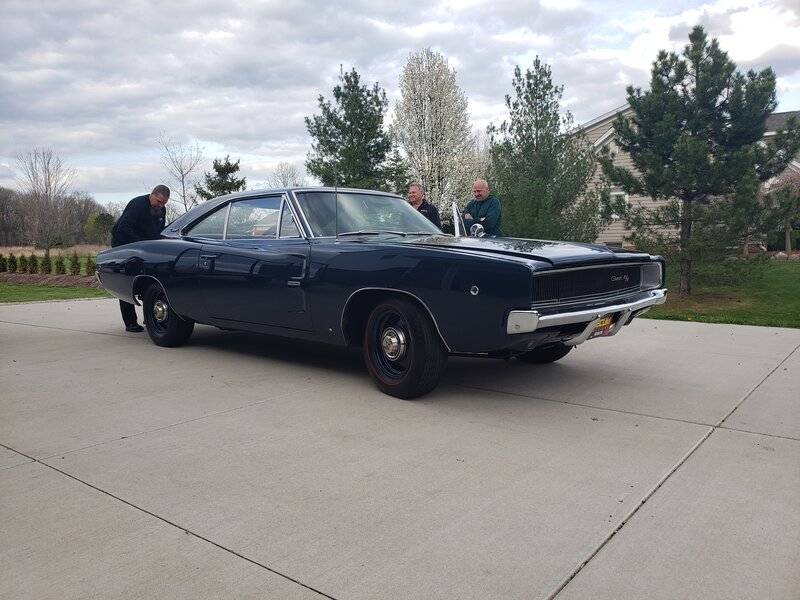

Hi Everyone. I'm new here and my father in law just purchased an original 1968 Hemi Charger. Whats great about it is, he bought it and I get to work on it and drive it too! 68 Charger is my dream car.
Anyway.. two things. When this car got delivered I noticed the idle speed was ridiculously high at 1800 RPM in Park. Drops down to 500 when in gear. I've only messed with carbs with manual transmissions on classic pickups. Not use to the dual quad performance engines and automatic transmissions. But really where should the idle speeds be at in park and in gear? Ive lowered the idle speed in park to 1100 rpm and in gear it drops below 500 and doesn't seem to like being that low.. what do I need to do to get this right? The engine is apparently all stock original low mileage never rebuilt.
Also where can I obtain a replacement air filter for this thats NOT a K&N or a filthy NOS one thats been sitting on a shelf for years. Just want a simple dry replacement filter.. apparently no very easy to find..

Welcome aboard! Big fan of 68 Hemi Charger's. I've had three different ones over the years. Your pictures look like the car that ran through Mecum recently in Houston. Is it??
Take a look at the ignition timing. Where is it at in park/Neutral?? I'm at work right now and going off of memory but I think it's TDC or +2.5 at 800 RPM ?? I think I'm at least close on that. Also check for any slight vacuum leaks. It's possible the seller jacked up the idle a little bit to cover a slight vacuum leak.
Yep this is the one from Houston. Thanks for the tips. I'll check on the timing and check for vacuum leaks. I appreciate it
