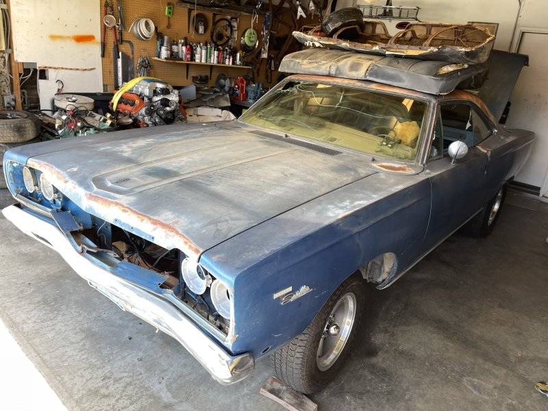

I almost have my 68 Sport Satellite driving, its not the first b body I've worked on. This one will be a dependable mostly original tire burner. If you have questions or problems with the car please ask, like most of the folks on this site I'm happy to share my opinion! Take lots of pictures of the car and everything you remove from it, the further you get into it more of its secrets will be revealed. This pic is when I got it
