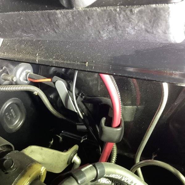

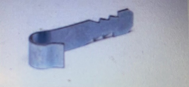

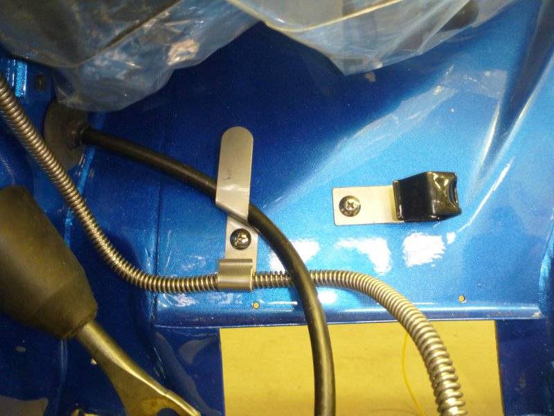

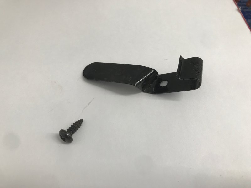

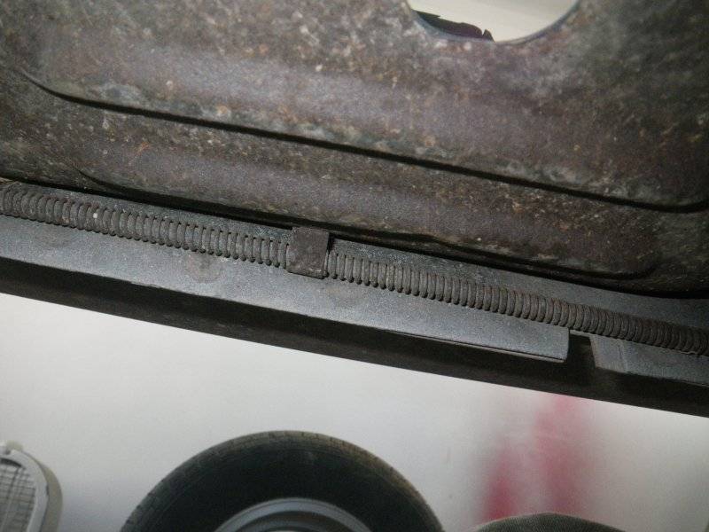

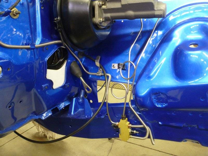

I am installing the brake lines and when I check my disassembly photos I see this retaining clip but don't find anything like it in my parts bag.
Anyone know what it is or looks like?
Yep and on my a body i forgot to install it couldn’t get it in afteR floor board install. That’s a later thing to get to. Good luck.

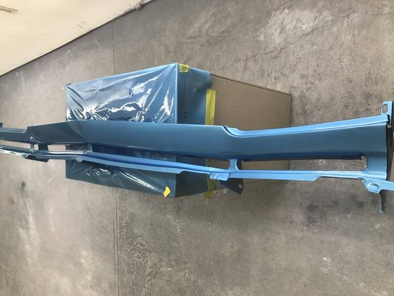

Worked on the lower grill panel these last few days. I took a lot of hammer and dolly work as it was part of the front end damage on the car when I got it.

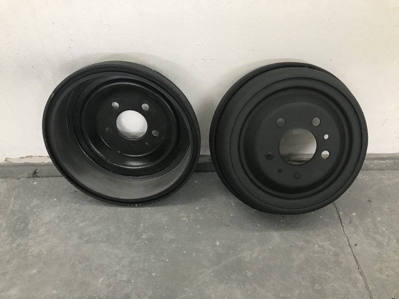

Pulled the brake drums, media blasted and painted them.

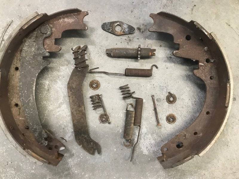

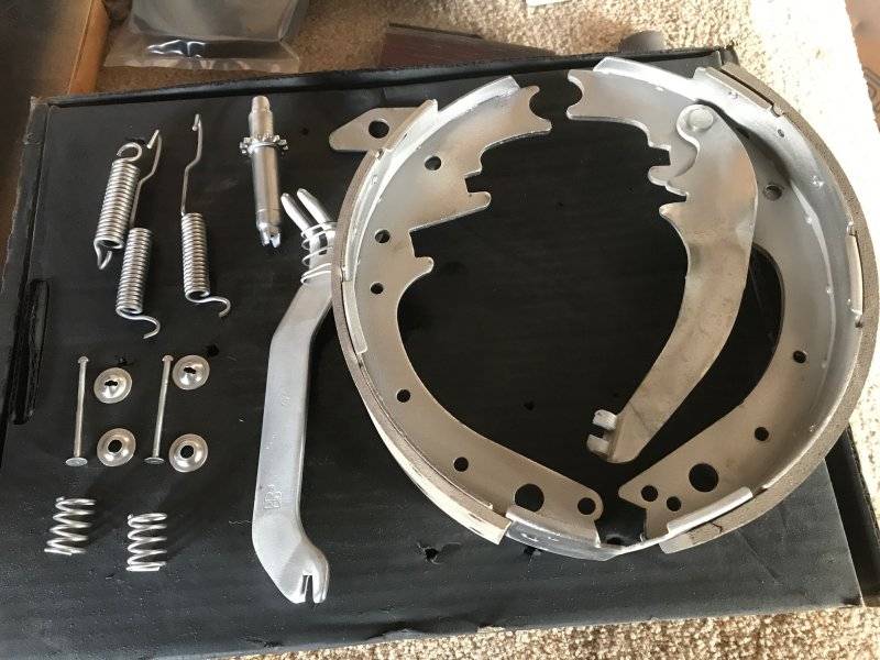

Removed the brake pads and hardware:
Ran one side through the blast cabinet and wire wheel to see if I could salvage them:
Turned out pretty decent so on to the other side.

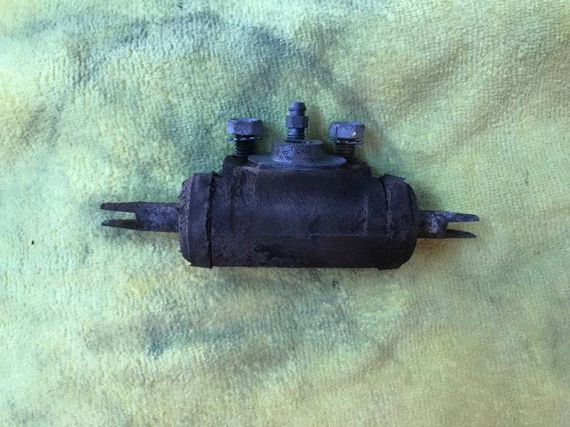

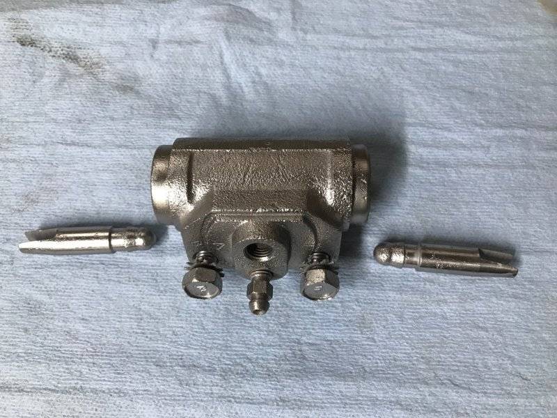

Wheel cylinder removed:

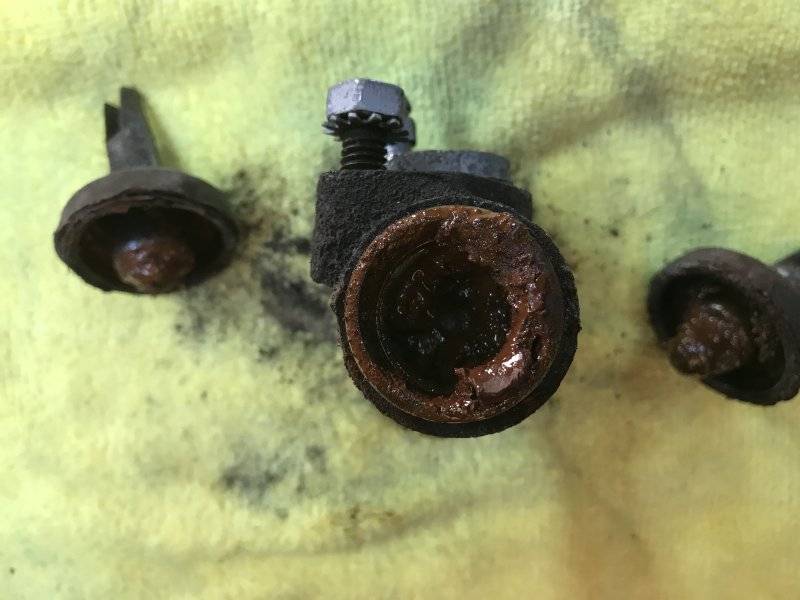

Needs a bit of cleaning:

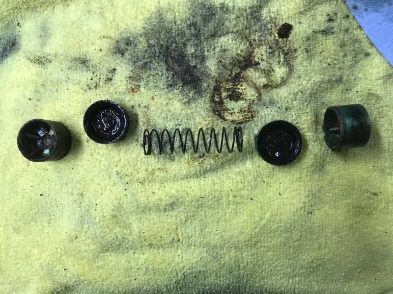

Got the outside cleaned up and ran a hone through the center.

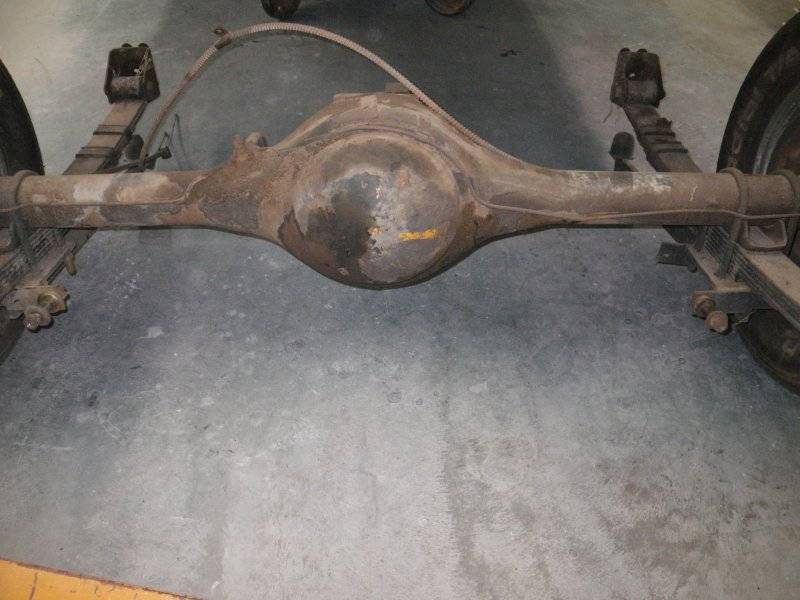

Looking at how dirty these are makes it clear I need to take a look inside the rear axle as well.
Rear axle was pretty dirty and rusted:

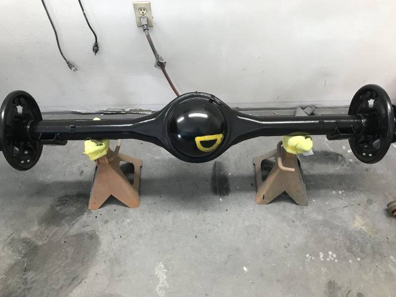

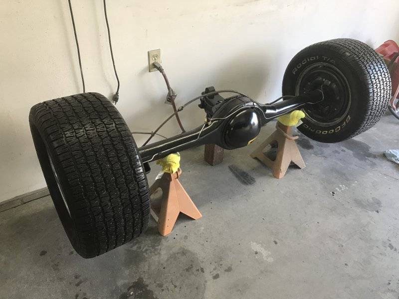

Media blasted the rear axle housing and applied two coats of black epoxy primer. Also duplicated the factory marking:

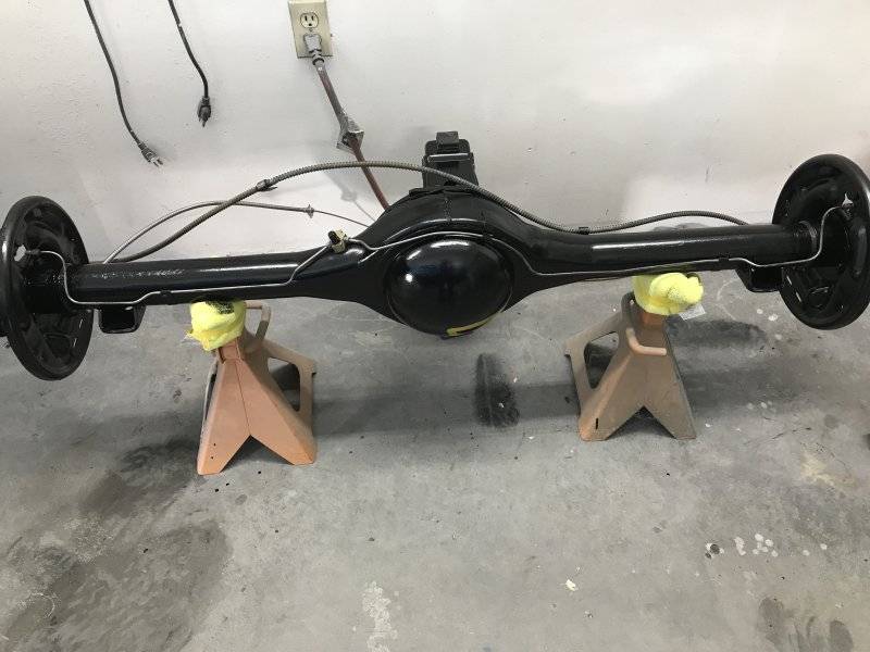

Cleaned up the brake lines and got them reinstalled:
Waiting for the wheel cylinder rebuild kit and then I can get the brakes and wheel drums installed.

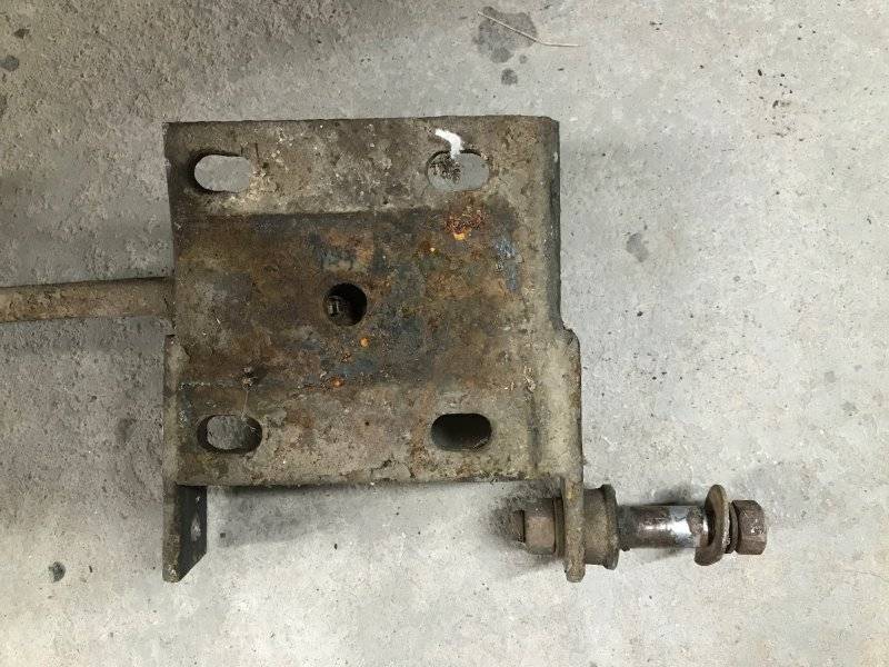

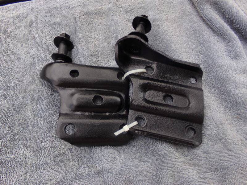

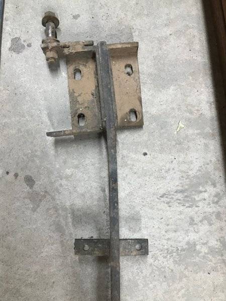

It looks like these traction bars were welded onto the bottom plates. Thinking I may be able to cut them off and salvage the original parts.
