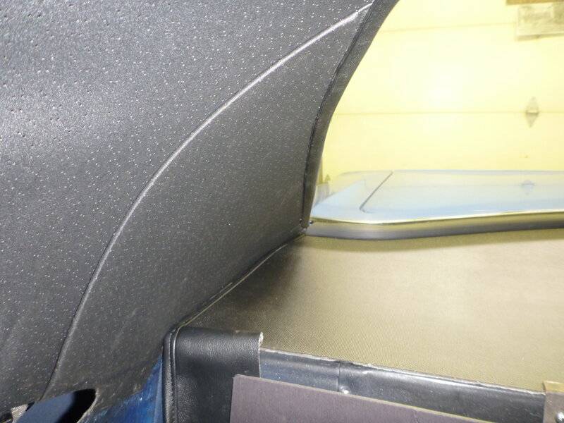

My 68 GTX was built in June and I have one piece sail panels. Two clips hold them to the sheet metal frame.
Here are some pic's. Other years had a slightly different set-up.

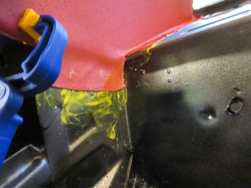

When I went to buy a headliner for my car I was lucky to call Legendary and talk
to one of the guys. They told me that 68 was the only year that had a seperate sail
panel and explained how the material was glued down under the package tray. With
all of the pictures out there, It wasn't very clear about what should be done.
