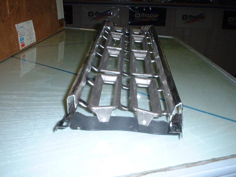

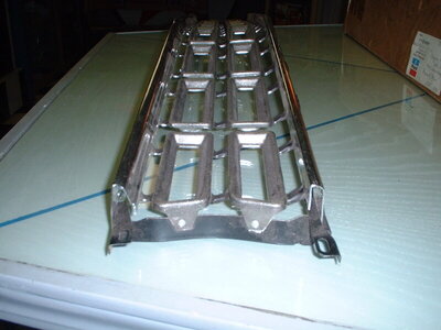

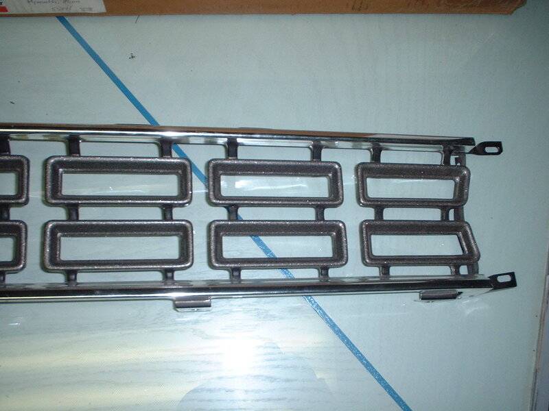

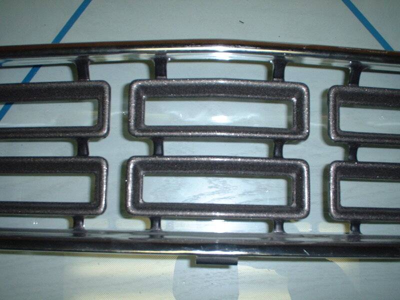

This is a NOS RR Grille that i have and this might help to get you close except the texture is hard to duplicate.
