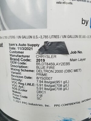

Just had my 69 RR painted with PPG Deltron B5. Fairly certain that 1970 is a slightly different mix.
Just confirming - This is the 1969 formula - not the new-since-2009 version? Thanks!! Have a pic?
Just saw your original paint code, so you can ignore the question, but do you have a pic of your car? Any other mixing codes on the can?
https://www.forbbodiesonly.com/moparforum/threads/my-69-road-runner.212496/
Here is a link to my thread. No idea if it a new or old formula, but they did take the mix out of a 69 book. Of course, in 69 it was single stage and mine is base/ clear.
