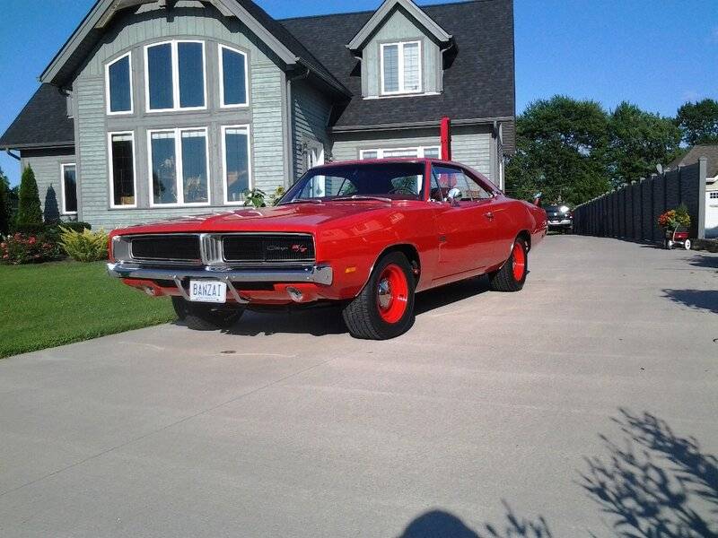

I have 255/60R15 on 15 x 8 (4" back space Ramcharger rims) all around. Stock ride height. These fit with no rubbing, albeit tight. You must install the travel stop spacer on the lower control arm bumpers that was used on the A12 cars. These tires are the same diameter as the OEM F70x15s, so maintain the same appearance in the wheel wells. It depends on what look you are trying to achieve. This combo gives the vintage NASCAR look and I have the stock red lines for when the OEM day one look is appropriate.

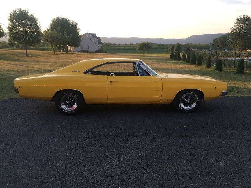

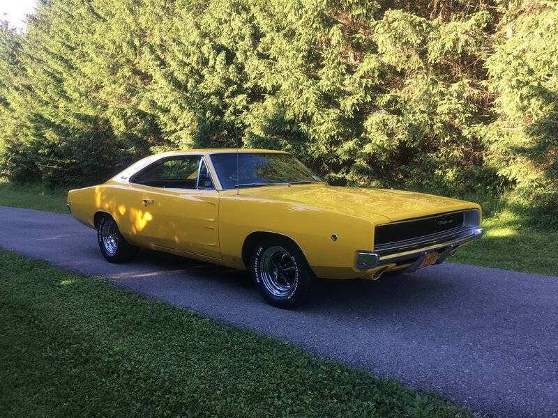

That is a 235/60/15 on the front and 275/60/15 on the rear. Not too bad at all just a tad bit of rake and looks mean. I like a 225/70/15 on all four if I was doing a standard tire on all four. I had 215-70-15's on my roadrunner at one point which looked like the stock tire size in a 15. 225/70 adds a little meatier rubber look. Its best to just search the hell out of cars on here and then ask the owner what size he has from the ones you like because you will find 2,192 opinions on tire sizes. Some guys love huge tires all the way around like a 245/60 or something, but to me it just looks like too much tire on the front especially.
