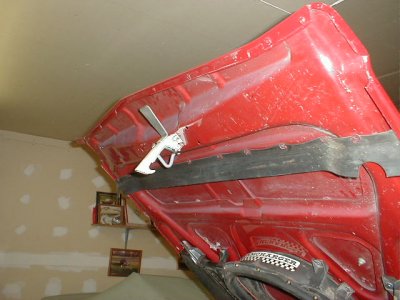

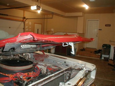

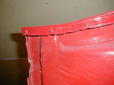

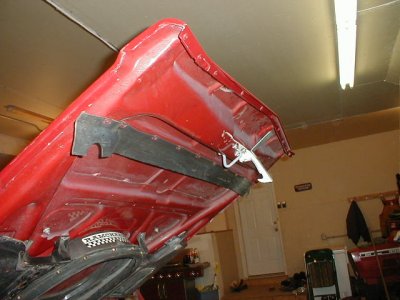

I'm working on installing a '69 Coronet hood extension piece soon, and I need pics of how its mounted, specifically what the screws look like. Assuming the mounting screws are sheet metal screws; any washers on them? Curious at how big the screw heads are.

I will take you some tonight. b right back
car parts 001.JPGcar parts 002.JPGcar parts 003.JPGcar parts 004.JPGhope these help.

I'm assuming those are just sheet metal screws, or are there bolts that attach to secure the screws?
yes they are just sheet metal screws. # 12 screws I believe. no nuts. if your using a 68 hood on a 69 just drill a few practice holes first on a pc. of scrap metal and make sure the hole is the right size.
