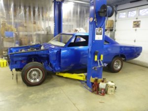

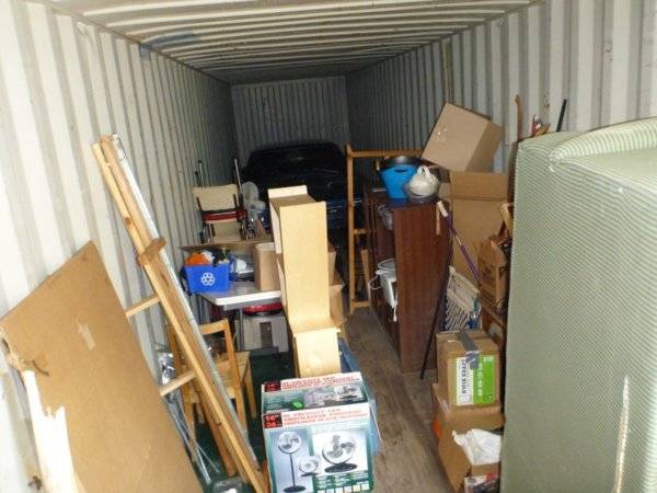

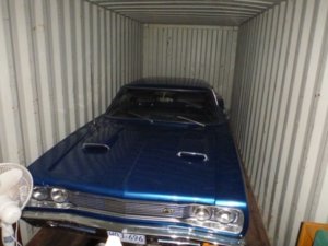

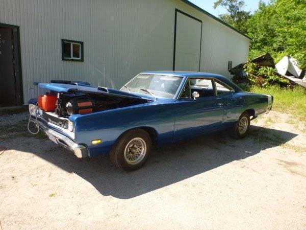

Justin (moparnation74) suggested that I should share my restoration thread here on FBBO. There is just no way that I can find the time to recreate/type/post the past 2 years of work so far, so my only real option to get it started off is to share my thread via link over on DC.com and then update the progress "live" here as the restoration goes on.
The back story on this car of mine is my father bought it as our family car and I bought it from him when I was 18 for $3600 @ 10% over 3 years. That was way back in 1980, probably before many of you were even born ! I put 45,000 miles on it during the 3 summers I was going to College (wasn't allowed to take the car off to school) and then put it away after getting married in it in August 1982. I got it back out in 1988 and had some body work done and re-painted and spent a few years doing car shows with it and my Super Bird that I purchased in Feb 1990. In 2004 I put them both away in marine containers, and then pulled the 'Bee back out to restore the Fall of 2014 to use as a distraction with one of my daughters fighting a 6 year Ewing's Sarcoma battle.. with us losing her in Aug / 15 at 30 years old. Is what drives me to finish this car and every component on it, in her memory. Paint is solvent based House of Kolor HOK-403, which is just a bit darker than B5. 4 coats of blue, one clear.. interfaced and then two more coats of clear to cut and buff once I have her all back together.

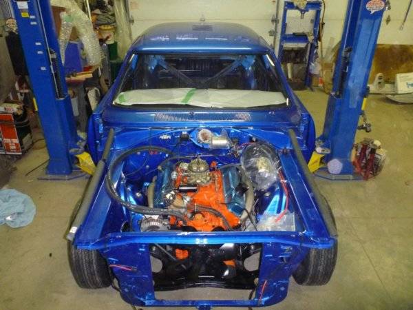

I've added a picture or three of where I started and two of where I'm at as of today. Also a picture of my Daughter Jennifer when she was 5 years old at World of Wheels Oshawa in 1990. If you've got 3 hours to browse the following link you can get caught up on the first 35 pages of "my story" ! Thanks guys for letting me in here... Wayne

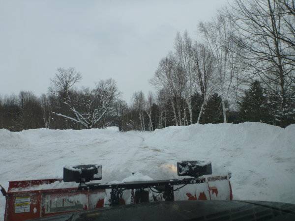

Hopefully tomorrow I can dig into my instrument cluster restoration and get some new pics up. I'm a glutten for punishment, the only thing I've sent out to a pro was my body! Today I got side tracked by 15" of snow and a 1200 foot laneway....

Wow you got dumped on! We only got about 3 inches. Where in Ontrio are you?

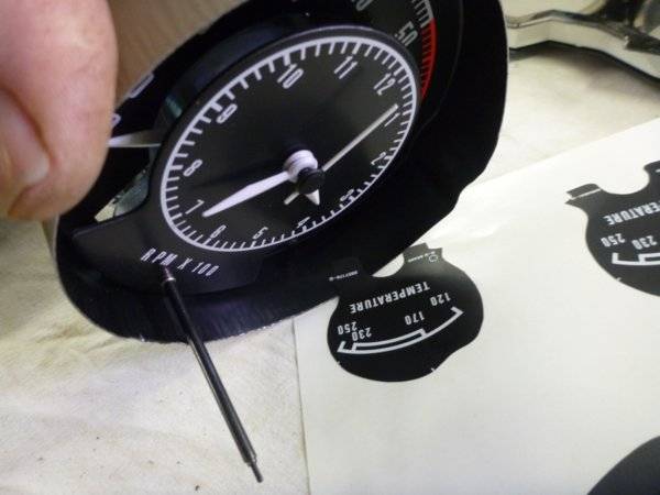

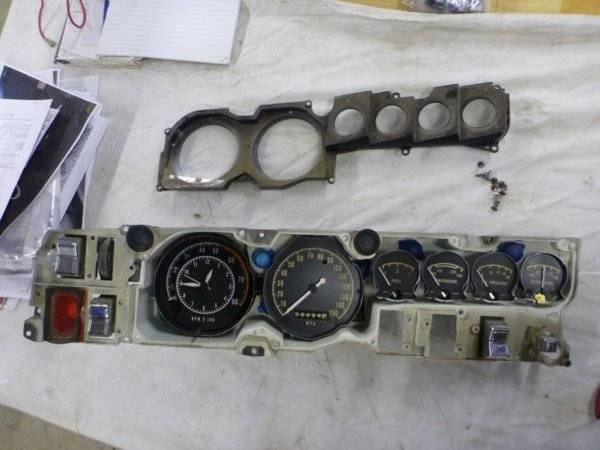

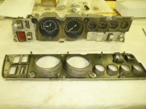

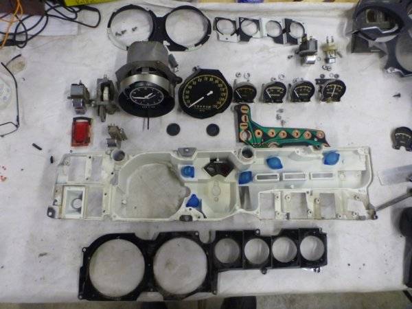

Well the snow still hasn't quit.. but I managed to get in 2 hours today. I'm going to make one "back" post to get going here and then continue on from there. To see the first 2 years of work hit the link in post #1 or #9.
49 years of dirt !
Wishing I'd just sent this down to David Patik at PG Graphics, but I've come this far I can restore this.. sure I can, what can go wrong?! LOL

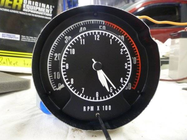

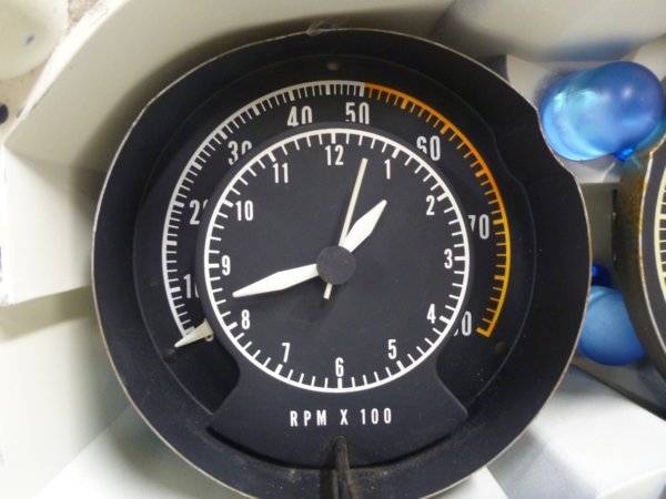

Original tach in dash is orange above 5000, hoping that's just faded Red. More to investigate.
New "OEM" tach has Red above 5000.

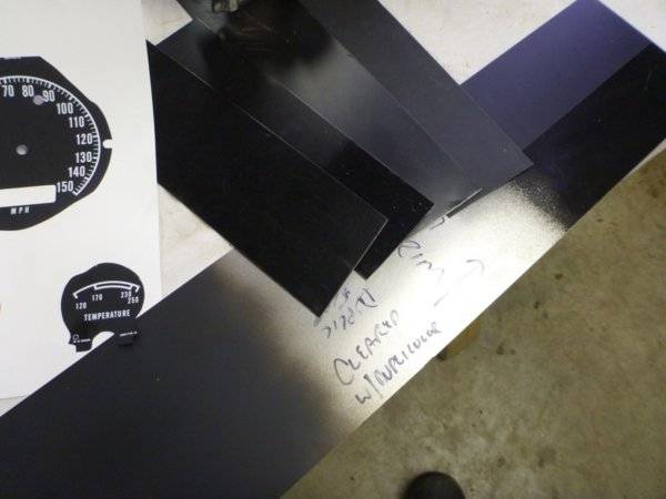

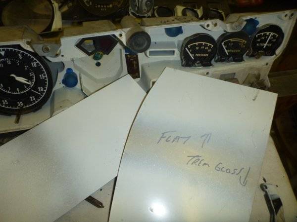

Well those 7 "Blacks" don't match the face decals... off to find some more variations of paint.
Also need to match colour to the slight shine of the "OEM" replacement tic tock clock / tach so it all looks the same.

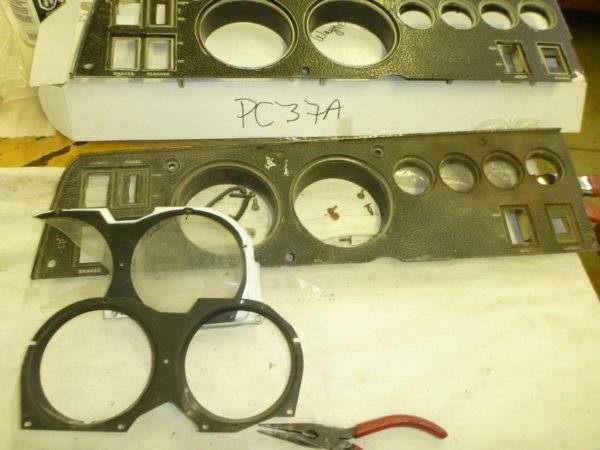

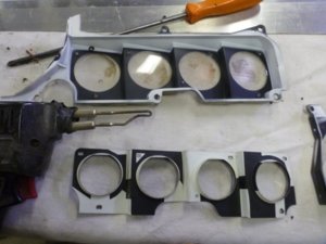

Great to have an old broken panel to practice on.. melting the plastic tabs for disassembly. Very little heat and you can push the metal off and keep the posts.
Enough playing.. time for the real deal.

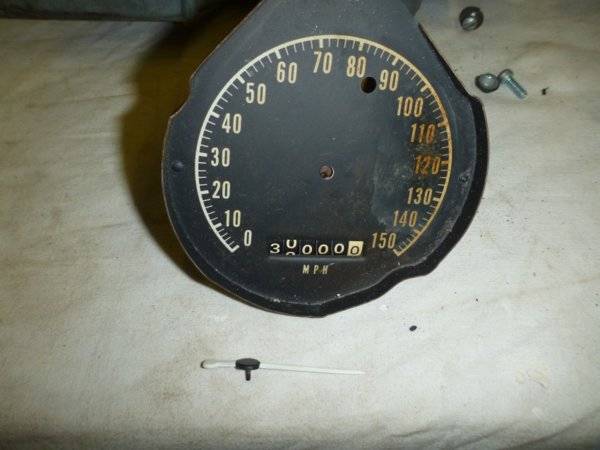

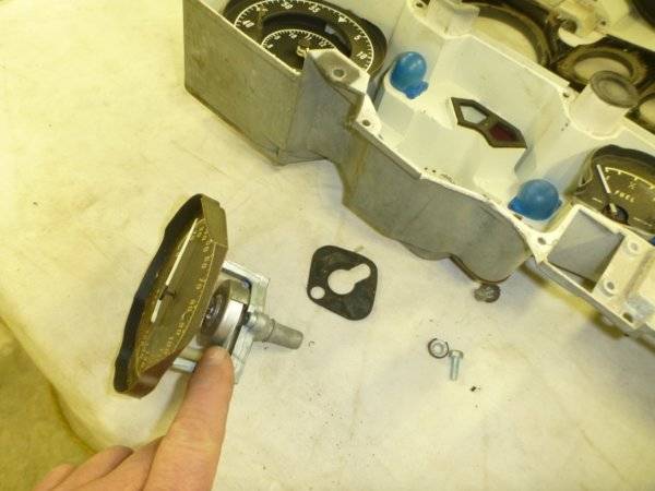

When you take your speedometer needle off, make sure you hold the metal wheel back or you'll destroy the needle shaft bearing and be looking for a new speedo or lots more work.
While holding the metal wheel, pull the needle's CENTER and twist below Zero and it comes off. Again practicing on my spare.

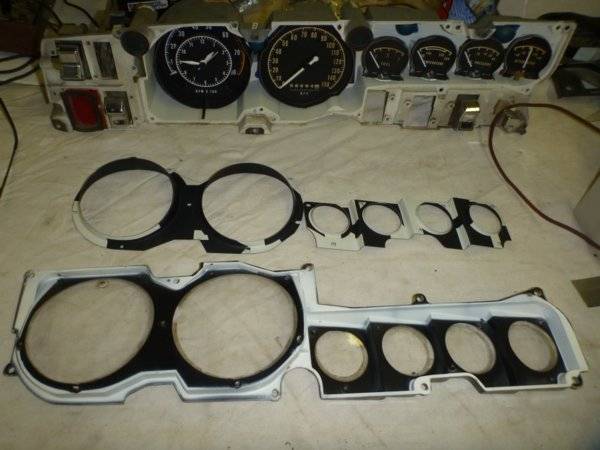

Car's original metal "hoods" to plastic faceplate apart and not looking too bad.
Thought I was going to get away without painting these, but then noticed the mold / corrosion on the tach hood.

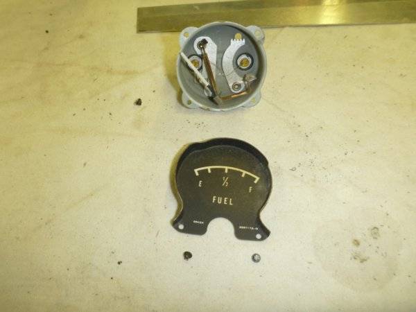

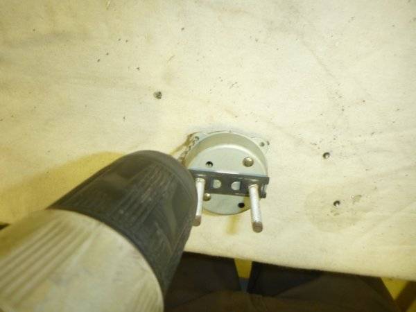

Don't want to fart around with trying to paint and decal around a delicate needle, so I'm drilling the rivets out so the faces come off the fuel / oil pressure / temp and amp gauges.
Practiced on a spare and all is fine. This also lets you see the adjustment arms for calibrating the needle.

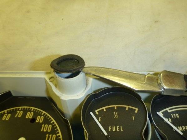

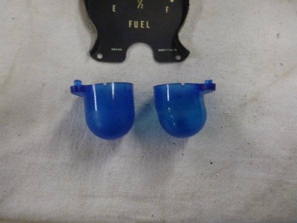

One of my dash light hoods melted after 49 years. Removed it and pulled the matching good one from my spare.
Good and melted.

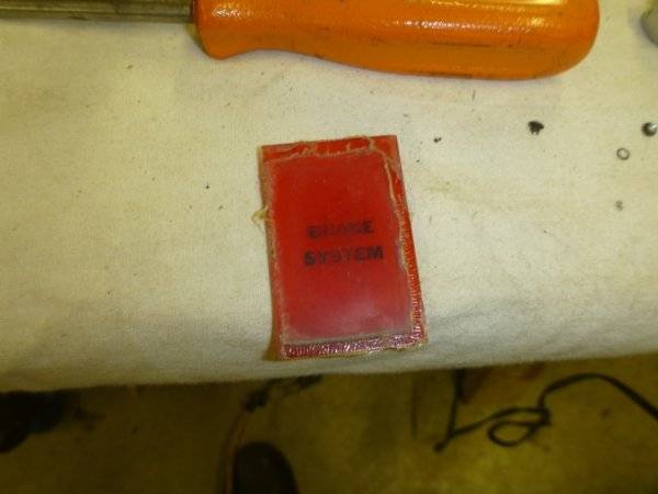

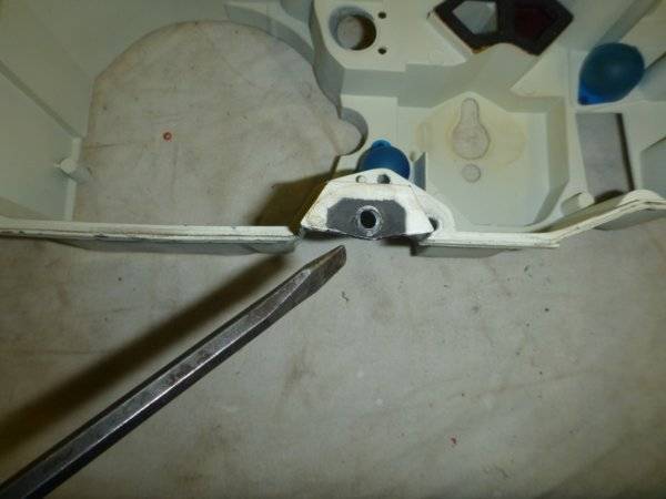

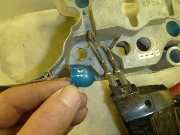

Heated the tabs and removed the brake failure lens.
Popping the signal lenses off.
Haven't busted anything yet..
feb518i.jpg feb518j.jpg feb518k.jpg feb518l.jpg feb518m.jpg feb518n.jpg feb518o.jpg feb518p.jpg
Finding a White that works for the housing interior, almost as fun as the Black.

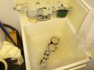

Thrown in the sink for a soak to get 49 years of crude off of it.

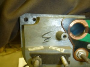

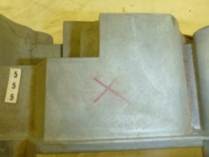

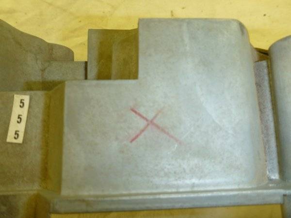

Factory markings... Red X.
I think it's a fancy 3 in Black.

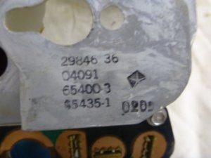

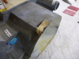

Factory part numbers and date code, for my Feb 25th, 1969 car.

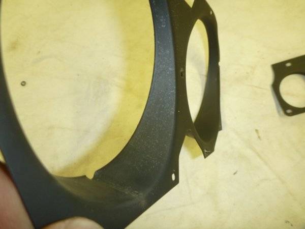

Paper tape on the tach housing area
Don't forget to paint the mounting screw areas black or the white ring will show through on final install.
