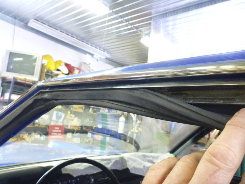

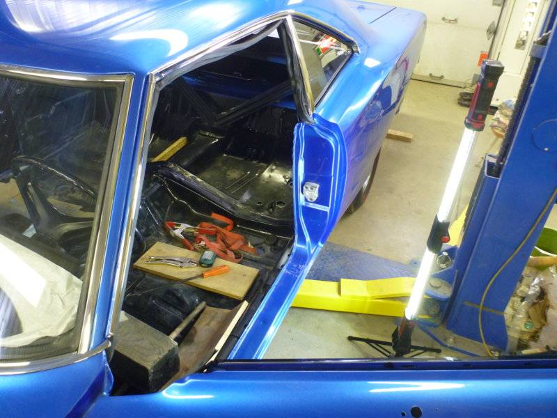

Working the seal into place. To avoid stretching I started at the B post corner as it was the most positive location. Then tucked the A post corner in place and the lower end on the A post where there is a location tab . Then worked the seal in between all locations.
Roof rail seal pegged in place.

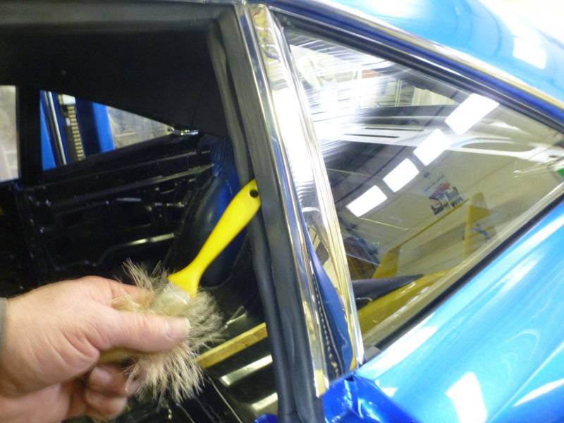

Again with the plastic brush handle soaked in window cleaner. Without the "lube" it's VERY easy to mar the surface of this seal material.

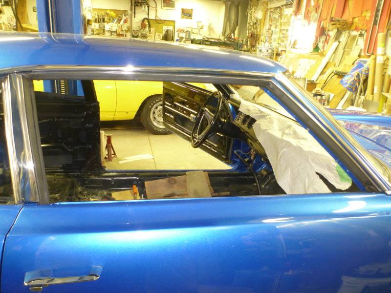

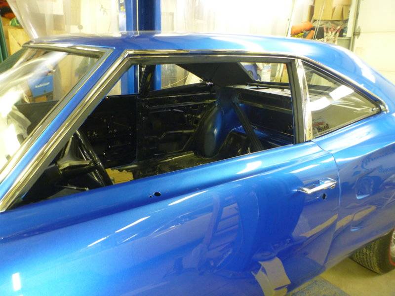

Drivers side roof rail seal in place.
Passenger side in place.

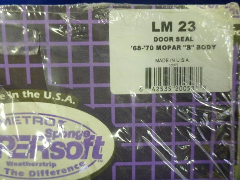

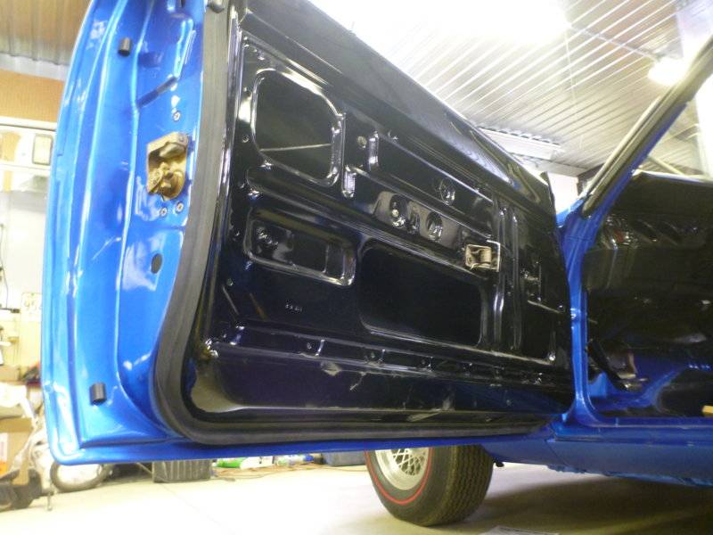

Door seals that I used # LM 23. They have been on since paint, but thought prudent to show part number and install.
Door seals fit VERY well. No glue on them, even though Metro states to use same between "pins".

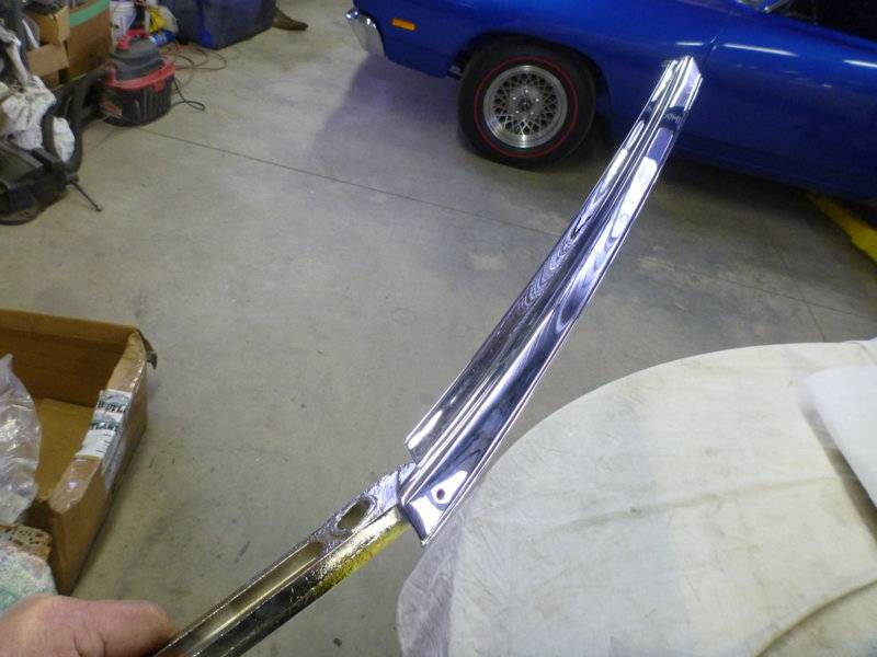

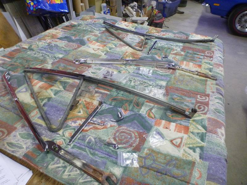

Wing window posts that were rechromed.
Now to put the puzzle together. Didn't even realize that the chrome / stainless polisher vendor didn't put them back together again.

Im currently in the same boat on my Bee, On the pop out windows, I plan on using 3M 1/4" butel roll squished up under the lip, then force the frame against the lip as tight as I can. Mine currently fit "ok" Ive only got the drivers side in, but I plan on removing them and wedging that butel rope up in there to bridge that gap.
There sure isnt a lot of tech out there for us Post car guys!
