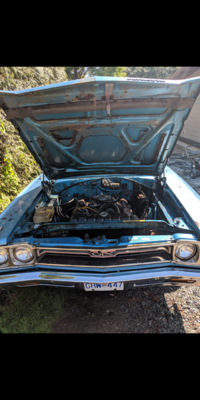

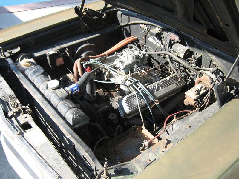

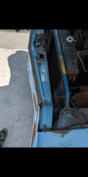

Popped the hood on this 69 GTX with a 22" radiator and something seems to be missing above the grill. The owner states it's been that way since he has owned it. It looks to me like someone put a 68 cross bar on a 69 am I correct?
Have any more pics? That does look like it may have a 68 piece on it.
RR and GTX have a different support do to the grill differences
Thank you for the replies!
I have always been told a 68 will not fit a 69 grill, but in this case it looks close to the 68.

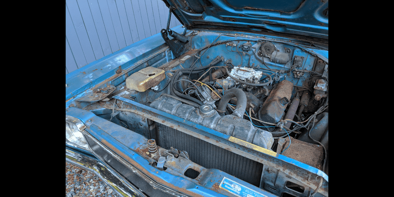

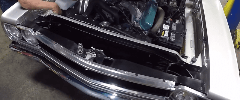

1968

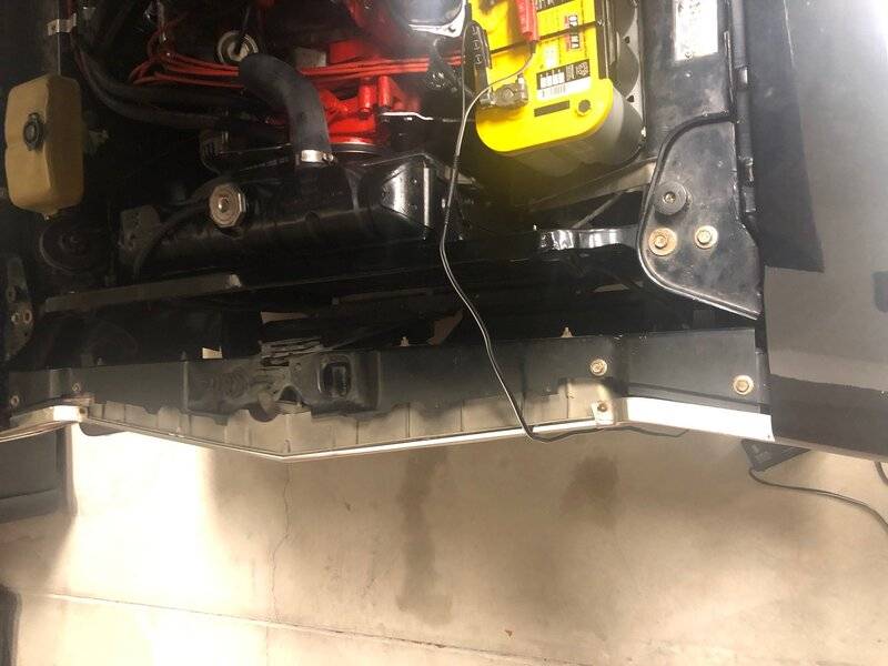

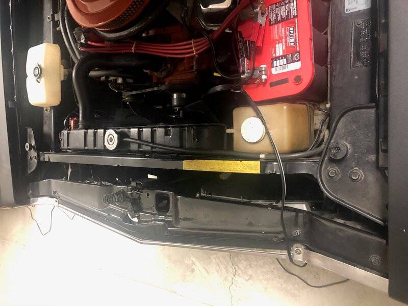

1969

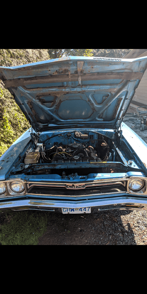

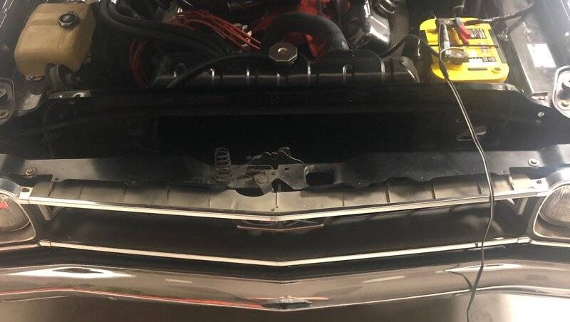

by the last pics you posted it looks like you have a 69’ grill and a 68’ latch support.

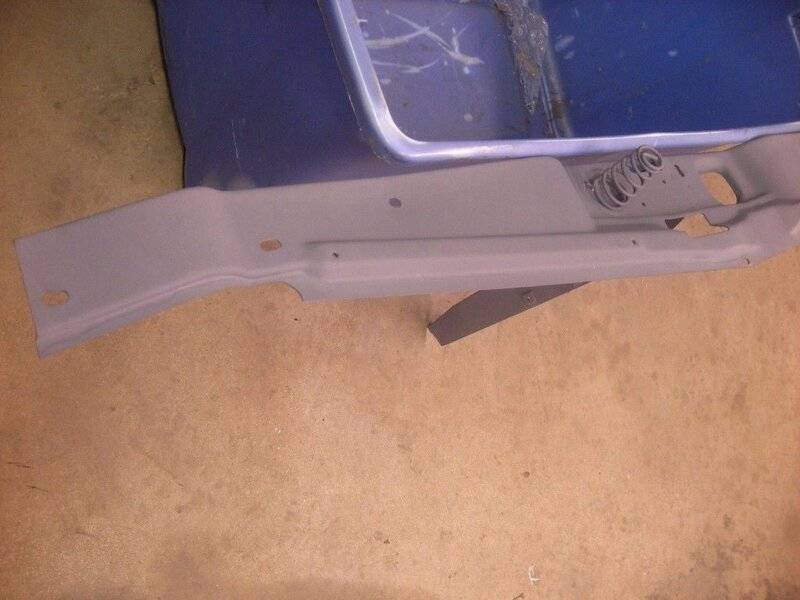

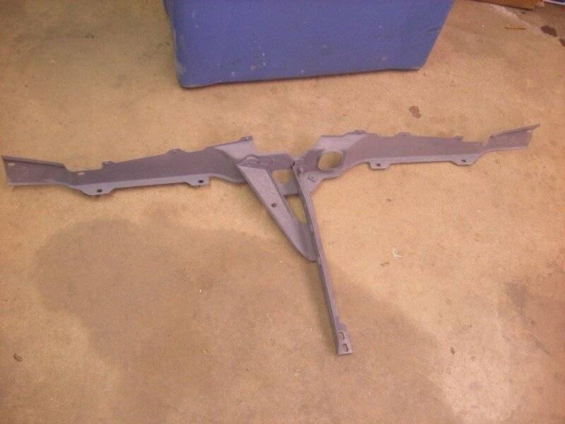

I have these but can't confirm accuracy...
1968 Latch Support

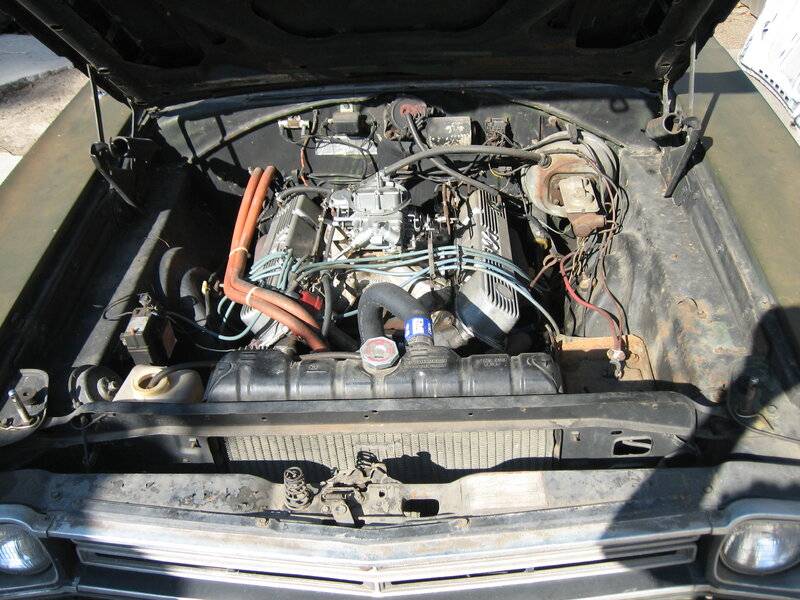

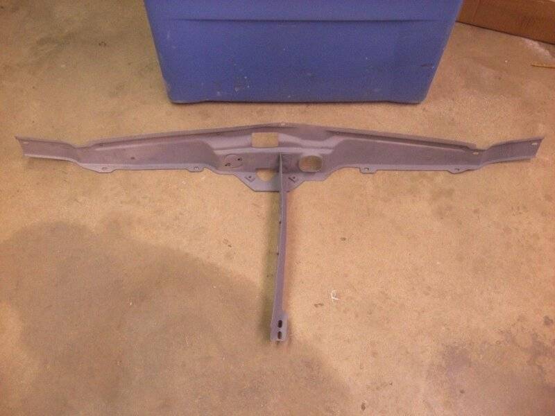

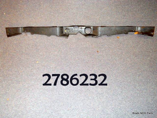

1969 Latch Support
