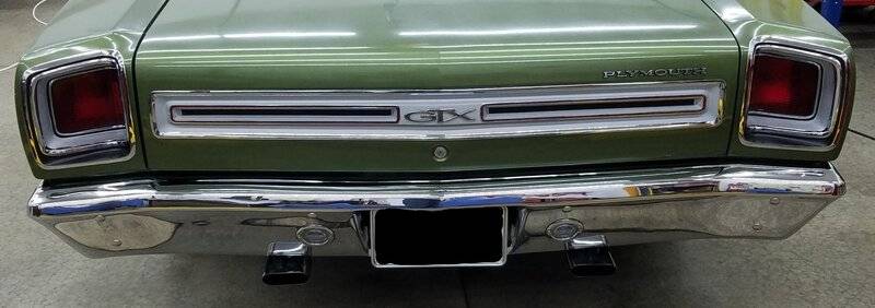

Here's one I installed a few years ago when Classic Industries first released them. You have to drill two holes to mount the "GTX" emblem, the panels are not drilled and I don't believe the emblem is available as a reproduction anywhere. The panel fit nice with the exception of having 1/4" - 3/8" gaps on each end because it didn't match the curve of the trunk lid exactly. I was able to draw it down most of the way on the ends then stopped fearing I would crack the panel or at least the chrome coating in the center. If I were to rate it at 10 being best, it would get a 7.5 - 8.0. They could also do a much better job with the red stripe and black paint work. Unfortunately if you need one this is about the only option you have.

That's just what I was afraid of. I'm curious to know if they re-tooled because of that problem.
