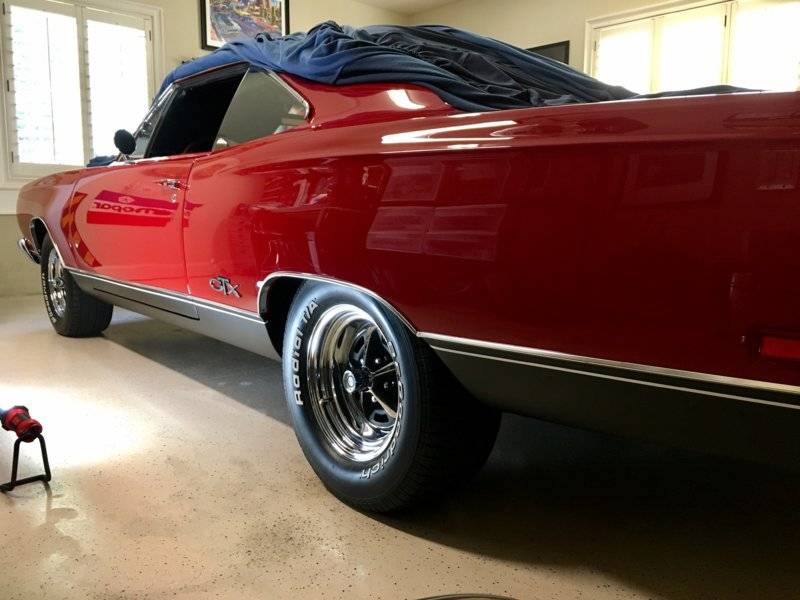

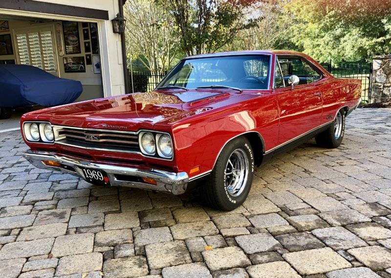

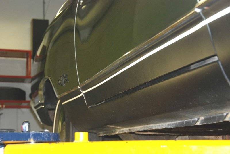

Does anyone know how far above the body line the holes for the trim should be (body line to center of the hole)? It seems to vary when I look at photos, but I don't think the edge of the trim sits right on the body line (or does it?).
Here is a pic from the Hemi GTX survivor that has been profiled in a few magazines and websites. I went out and looked at mine also. The stainless strip is right above the body line, so just before it starts to roll inward. But it varies panel to panel. You can see the shadow on the door jam in this pic, near the quarter

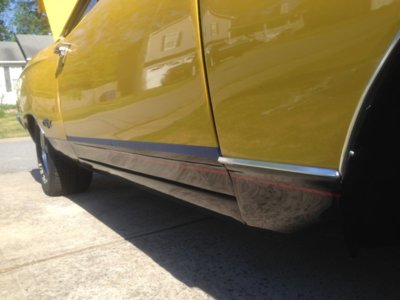

Here is my front drivers fender. Original fender. Seems to match the survivor GTX in the pic, though the part in front of the wheel seems just a tad higher, so not sure what their tolerance was

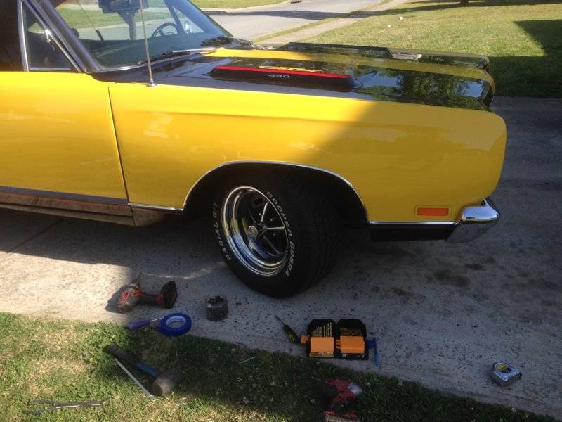

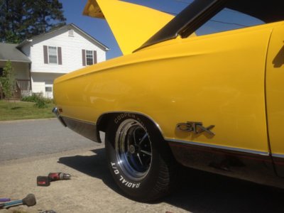

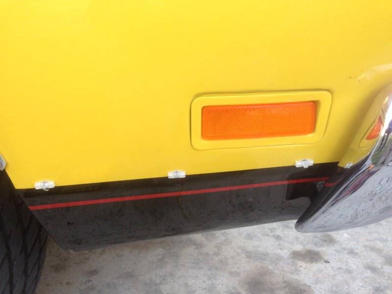

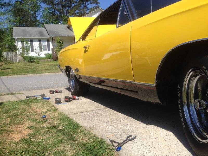

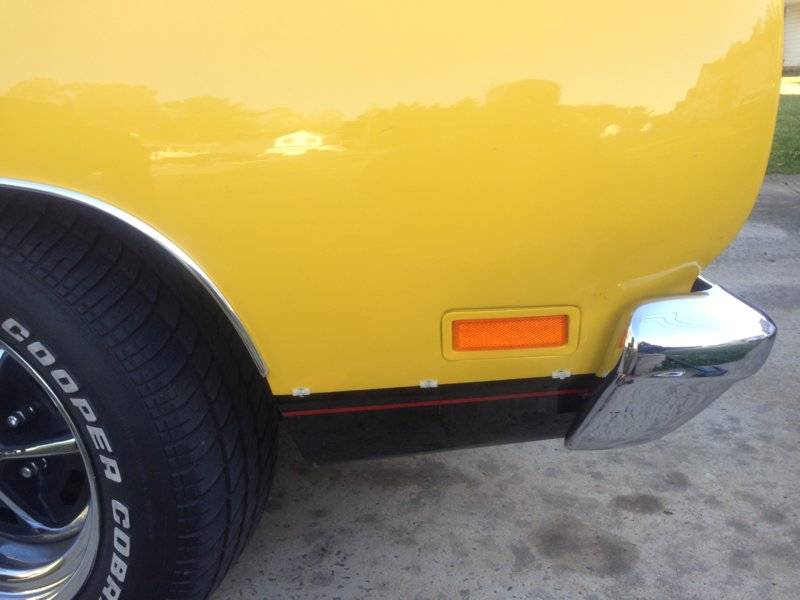

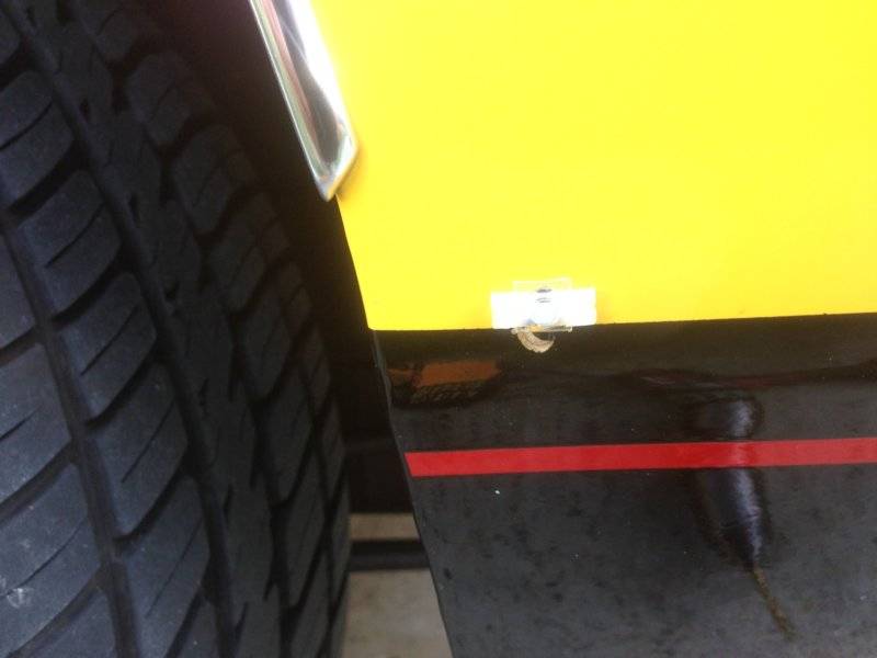

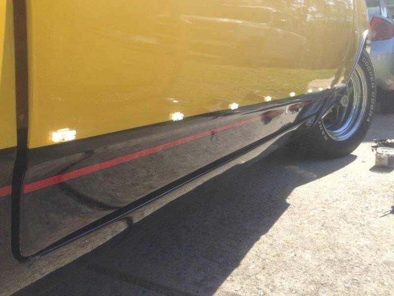

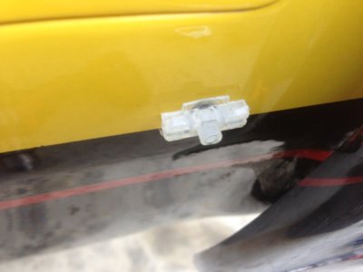

Here is a 69 I installed the chrome on. Maybe it will help. Whoever installed the arch chrome was way off I had to take it off and rotate it forward to meet the front chrome piece.
