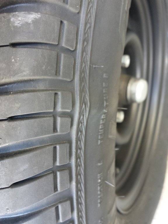

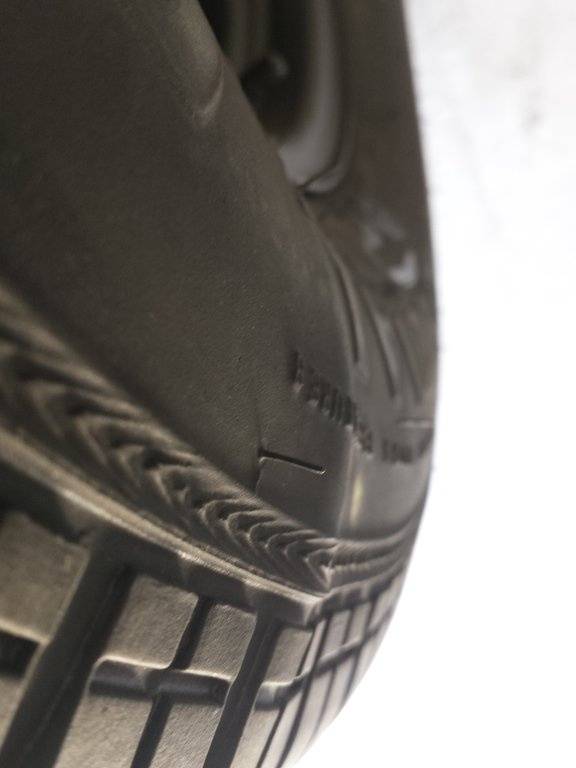

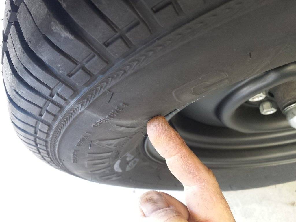

I also have a new front tire coming from Summit as the driver side tire has a bulged out belt after 30 miles or so. They are taking care of everything including the swap.

More issues with the tire/wheel. I received the new tire, had the old one pulled, new one installed and....the rim has a bounce to it so they couldn't balance it. Looks to be the hub center as he showed me the wheel on the machine. He pulled it and remounted it a few times, same result. So I have a new tire on an unusable rim and a bad tire unmounted. Summit is sending a new rim.
that's insane! at least Summit is looking after you.
Yea, their customer service is tops. I did not feel a front end vibration when driving it either. On the old tire, where the bulge was it is missing a belt so it is just rubber that stretches out when inflated. Crazy. They are crediting me the cost of a mount and balance too.

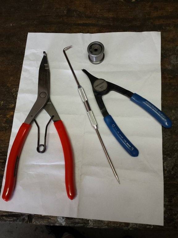

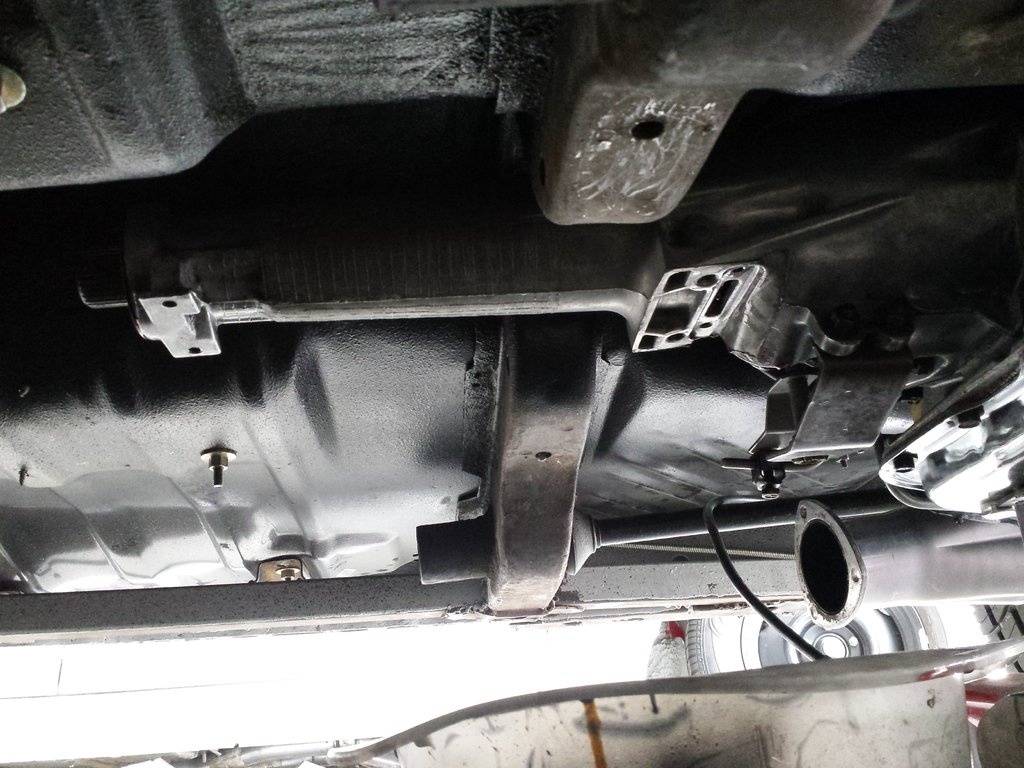

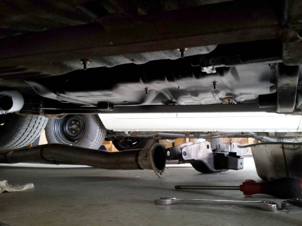

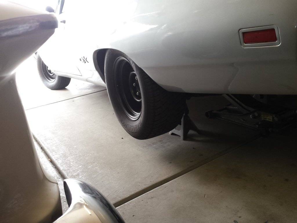

Candy makes everything easier! So, I gathered my tools and started governor surgery. This is where I am glad I put in an exhaust that is easy to pull down. The trans crossmember has to come out as well as the mount itself to gain access to the external snap ring that holds the extension to the trans body. Have good external snap ring pliers as this one is a pain. I jack the rear up to keep fluid loss to a minimum. Then a transmission jack under the pan.
And once all the stuff is out of the way the extension gets pulled back and you can see the governor.
The large internal snap ring comes out as well as the e clip then R&R (the e clip is a royal pain to get on as you need one hand to hold the axle pin down on the opposite side). So, I have the new one in, and extension bolts hand tight. Came in to cool off then I will button it up and take it for a spin with some video hopefully :)
