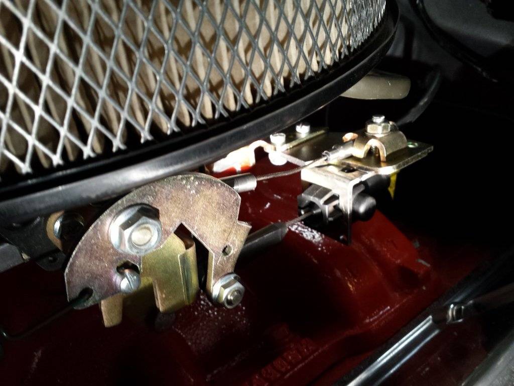

I was having an issue with the 2-3 upshift at WOT. It was hanging for a while at shift point and sometimes would shift and sometimes I would have to let off a bit to get it to go. Well, it seems that because of the TF2 shift kit heavy pressure regulator springs I had to back off the throttle pressure lever to where there is some slack after the throttle opens before the pressure lever moves. Nice and crisp shifts at 5400rpm now. I didn't get a whole lot of testing done as it is still 104 degrees at 8:48pm in the evening plus storm clouds are building. But I believe the adjustment is very close.
Before driving it around I finally fixed my Bouchillion bracket. As made, it does not allow a linear pull for both the throttle pressure cable and accelerator cable because they are offset. So I cut and re welded the lower bracket for the kickdown cable toward the carb. It is now directly under the accelerator cable and pulls true.

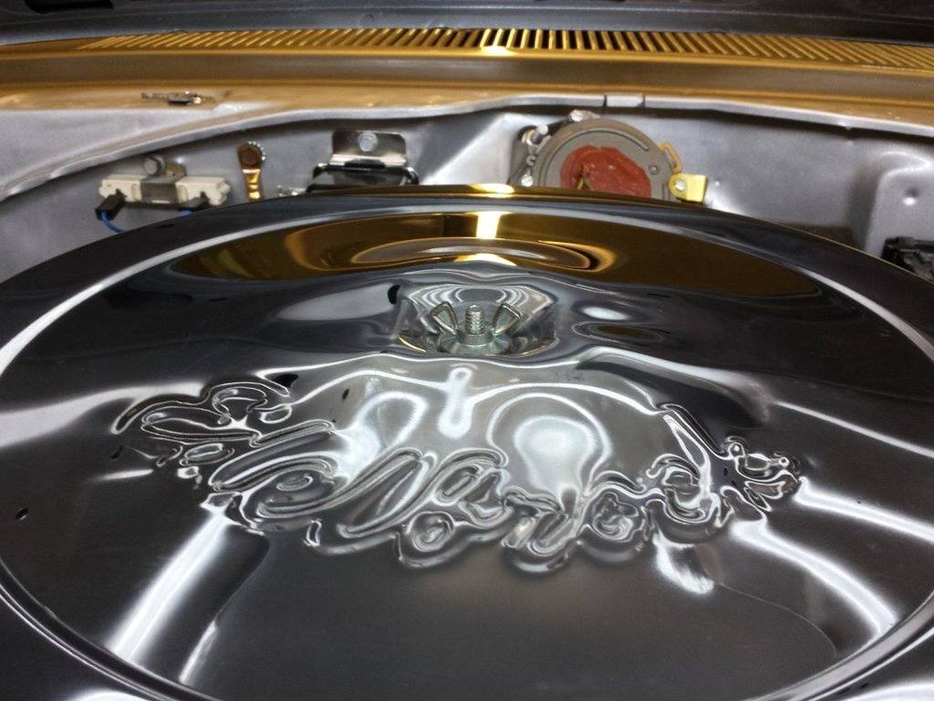

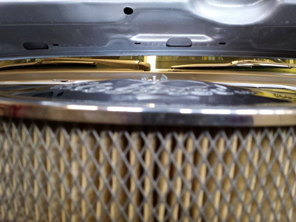

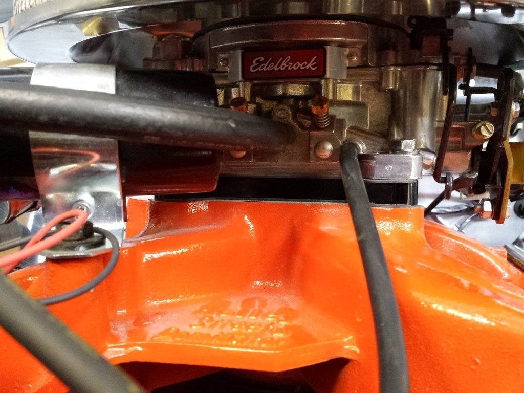

For the fuel side, I decided to installl a phenolic carb spacer and to re route the fuel line away from the headers. To get the spacer to work, I had to recess the air cleaner top for hood clearance. I used my shop press and a large socket.

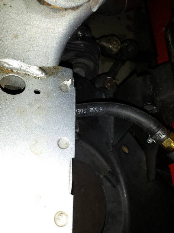

And I routed the fuel line under and around the wheel well and back to yhe pump under the splash shield. Hopefully this helps, it definitely won't hurt.

Can boiling fuel cause a lean condition at wot while not effecting low / medium engine load ? How about float levels?
It is a non issue at night with cooler temps so I am scratching my head. Would or could plug wires be sensitive to temps when under load? I inspected the engine running at night in the dark and no visible spark jump. Obviously harder to see during daytime which is when the stumble occurs. Gotta be fuel or ignition...
