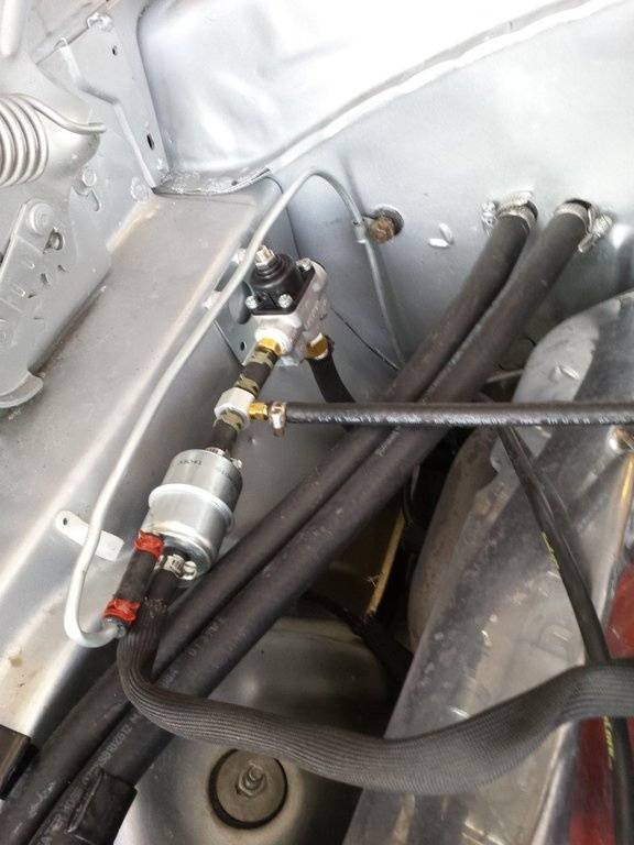

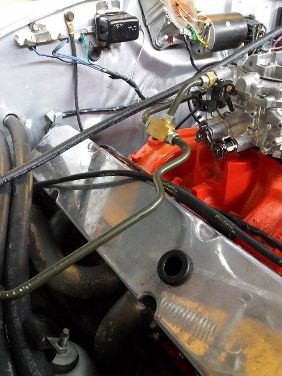

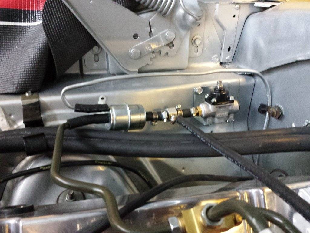

Choke is wired open. It is a hot mess out there in the garage. I have the regulator test fit up. I still need to run the 3/8 hardline to the inlet side. Then I can move on to mounting and wiring the pump.
I got the fuel line ran up front, going to slip the heat sleeve on and finish it up tomorrow.

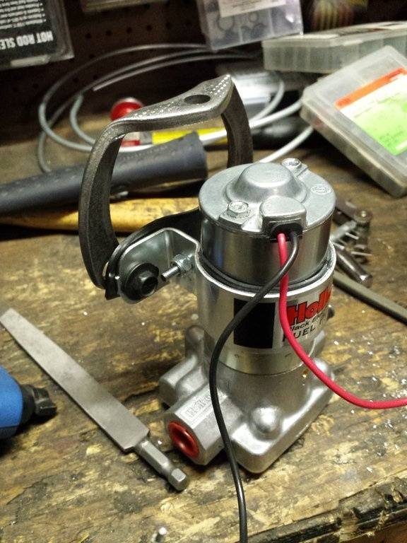

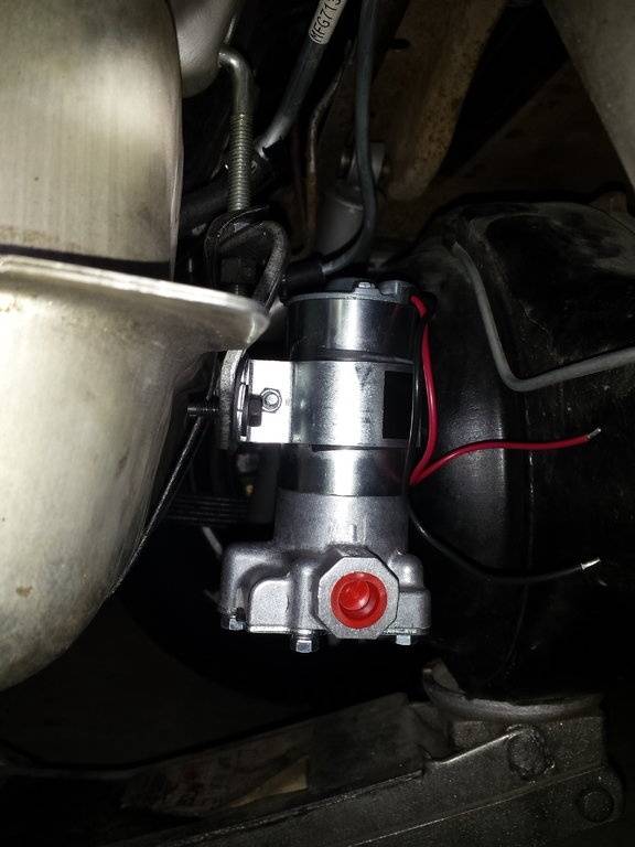

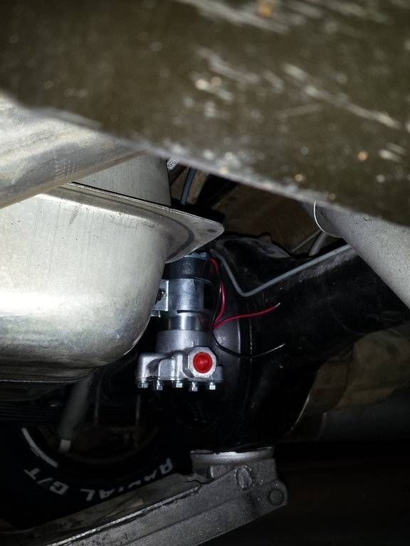

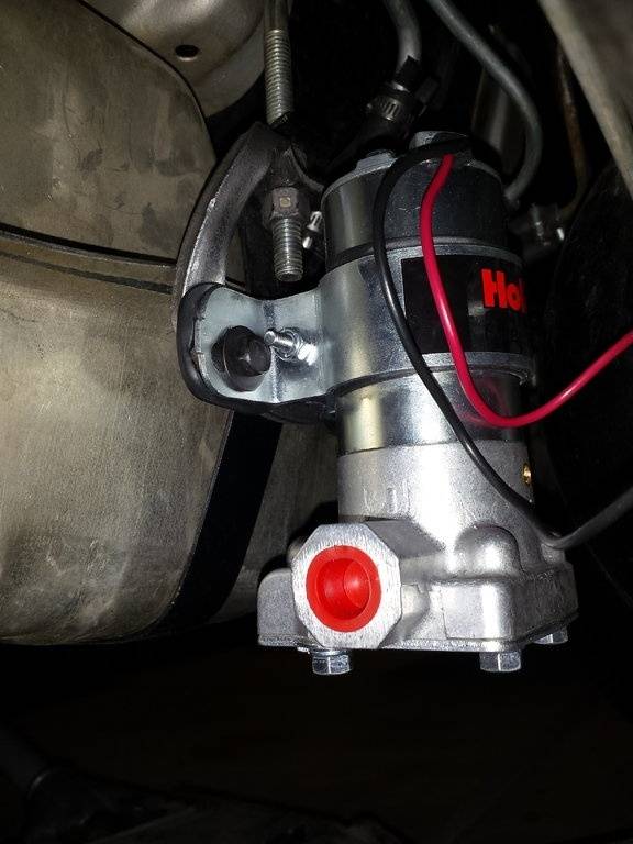

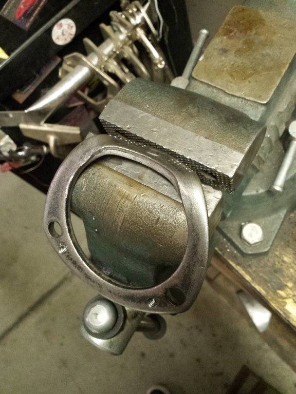

I also have the fuel pump mounted. Now, there isn't a whole lot of real estate to mount it and the instructions say to mount it low to get syphon effect when pumping. So I was limited but think this should work.
I used a spare exhaust collector flange with a corner bent over and mount holes for the pump tapped. The rest has an s bend to tuck the pump near the bracket.
The bent over mount hole slips over the pass side tank hanger bolt and gets bolted up. Not shown is a clamp that will go around the tank strap and pump to keep it in place.
Nice bracket! Necessity is the mother of invention! So when are you driving that to Tucson? The Cops and Rodder show is in November. I have a windshield gasket for you to change out.
It was amazing how easily it was repurposed and that is the only place it would work. And if I knew what a pain in the rear this fuel delivery was going to be I would have went FITech.

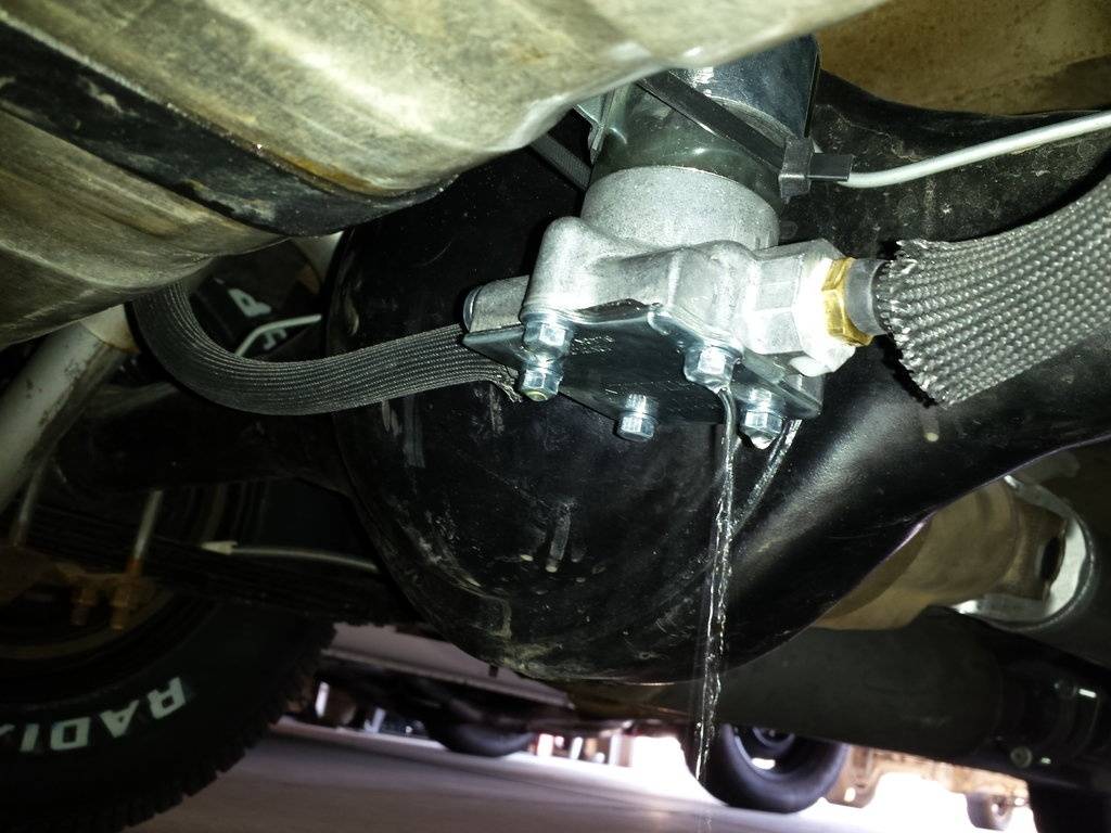

Holley can bite it!! Finished up the pump install today by wiring a relay and toggle switch for the pump. Buttoned it up, connected the battery, key on, flip switch......whirring of pump along with the smell of gasoline. Shut it off, take a look under and see........
A waterfall of gas from the lousy plate. Bonus, it is a gravity feed so it keeps coming. I grab some clamps to block off the inlet and outlet hoses to get it to stop peeing. Pull the bottom plate off and the f#$%ing gasket is in crooked! Terrible QC, obviously they don't test them from the factory and didn't care about this one. I have a video I made of it gushing that I will send to Holley. The language is rated R. Never again.
So I fix their $hit and get the car running. Fuel pressure is high and I am ready to blow a gasket. The Quick Fuel regulator adjustment does nothing, in and out, stays at 9psi. I am ready to burn it down. Turn it off, make another adjustment, fire it up and the psi had changed. So I adjust it to 5 1/2 psi by adjusting while it is off and....it holds steady. No road test yet as it is way too hot still.
And the pump....sounds like a hive of angry bees. You can hear it with the engine running. I have some sound and heat mat left so I am going to cover the back seat well and see if it helps.
