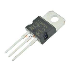

That might as well be hieroglyphics lol. Would a 3 prong regulator work? Say 14v in, 8v out and ground? Something like this mounted to a heat sink...
Any non adjustable fixed regulator? I like the idea a lot.
That works but I am running my stock 34A alternator so getting 10% of the capacity back with the switcher was advantages to me. Look for something on digikey. Vicor bricks are good but very pricy.

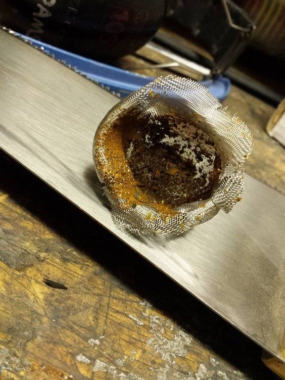

Radiator cooling tubes are all gunked up so it needs to come out. I needed to flush the system again anyway but I am pretty sure that is the cause of my overheating.
Success! !!!
I pulled the radiator and let it soak with CLR/water and it didn't seem to do much. There was a layer coated inside the radiator tank. This will sound strange, but out of sheer wonder I loaded up urethane reducer and let it sit for a while.....it flippin worked! Sheets of brown scum came out. Even more with agitation inside the tank. This is one of 3 loads of crud...
So I rinsed it out with water, reinstalled everything and inserted a screen in the top hose to keep more crud from entering the radiator. On my test route (10 miles, same as previous time) the temp kept creeping up and up. By yhe time I pulled into my garage she was kissing the upper limit. F$!#!
So I went out back, did some yard work and contemplated driving the car over a ravine. My next step was was removsl of the t stat. As I got the upper hose off the screen was blocked with crud.
Which could be the cause so I removed it and took her out again.
Same route and the temp held. I even stopped for some celebratory beer:)

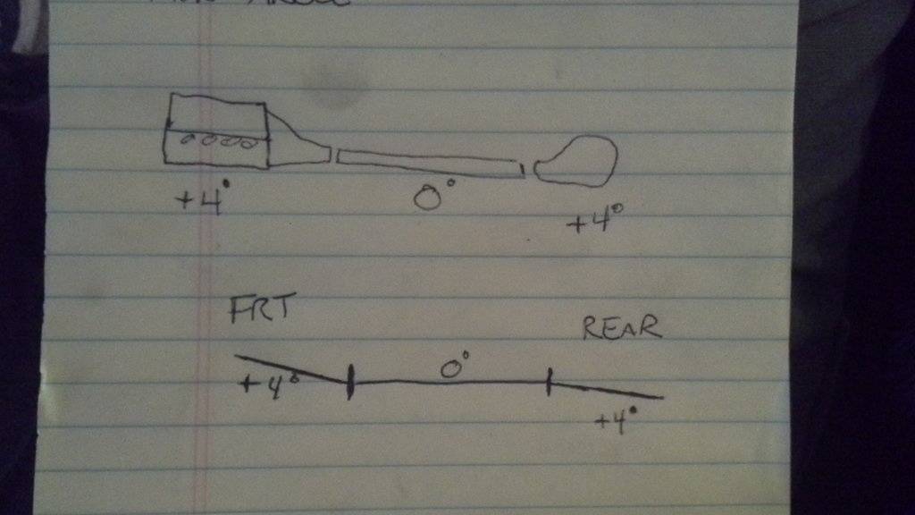

Moving on to pinion angle. Here is what I measured. Engine is 4° tail down, driveshaft is 0° and the rear end is 4° nose up.
Which equals 0 and is good. But I want to set it up so under acceleration it equals 0. How many degrees would a set of s.s. springs on an 8 3/4 rear wind up?
The rear pinion should be down 4 degrees or more at rest, when accelerating the pinion will move up 4 degrees and zero out, with slicks on a track it might come up 6 or 7 degrees on a stock suspension.
Thanks. That was kind of the direction I was leaning. I have a set ordered. I was a little concerned because there are scrap marks on the driveshaft end where it was contacting the rear pinion yoke on acceleration so this should stop it from happening.
