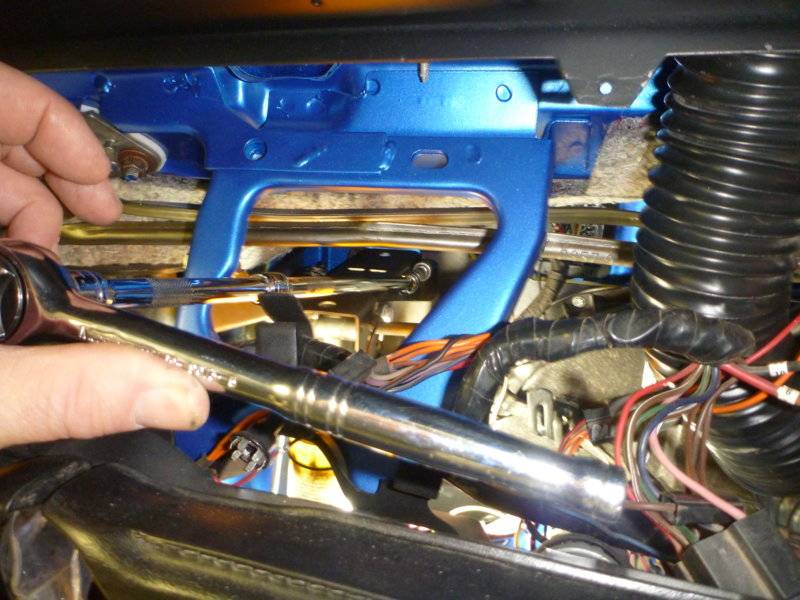

I like it except for pulling the switch panel and cluster.
BTW can you share with us your technique to place that upper right nut on the master cylinder mounting stud?
Other than hearing that it's difficult I never really hear how it's done. I actually taped the nut to my fingertip to get it started on the threads.
CHEATER!!!!!!!
Sounds like the correct way, but can't seem to ever get it started that way. I know many b body cars are out there without this nut in place.I used a short 1/2" socket, flex joint and extension. Put the nut in the socket and raise it into position and get it started by turning the extension.
