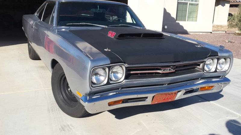

Here's another shot. I had them made on reflective laminate like the originals. I have more sets for anyone else interested.
