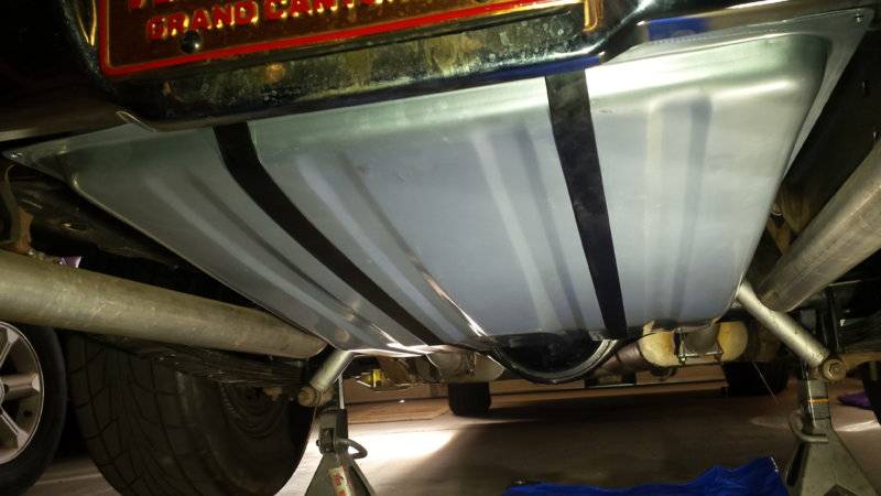

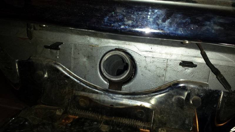

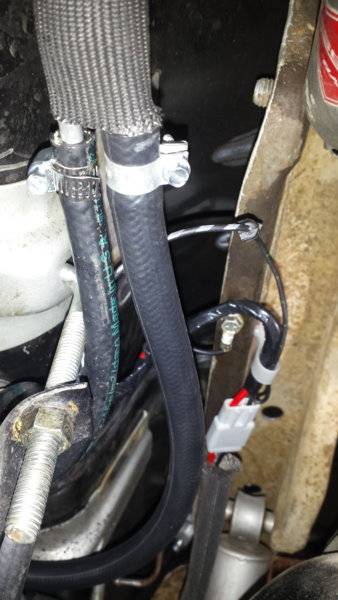

I have my 3/8" return fittings installed and I should have my 3/8" line tonight to finish it. Here are some pics. I created a wiring harness so everything is easy to remove if needed. Fuel filler tube fits perfect.
3/8" return line installed and pressure is a nice steady 6psi at the regulator. No leaks and boy is it quiet!!! Drove it to work today and I can hear myself think at idle. I think it was worth it.

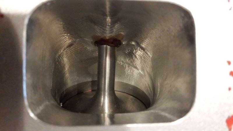

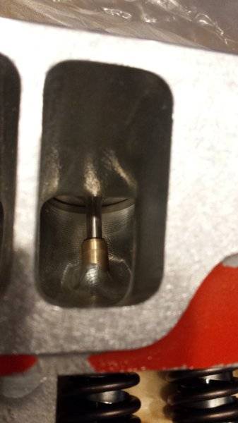

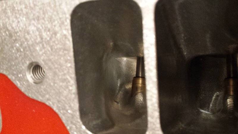

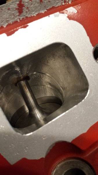

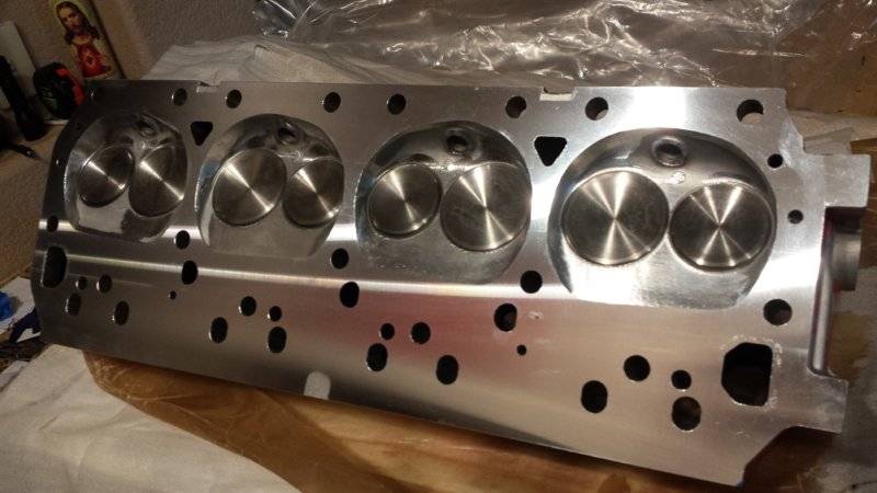

Small update: I had a few wet plugs from my valve seal install and said "F-it, I'll let someone else do it this time." So I sent the set out to Bob at Modern Cylinder Head and had him replace the seals, 3 angle valve job, deck the surface and run a CNC port on them! All told, it set me back $1165 and the turn around was very fast. Thanks Bob, very nice doing business with you!!!
The flow sheet on my heads shows 311cfm @ .550 lift, tested at 28 in.

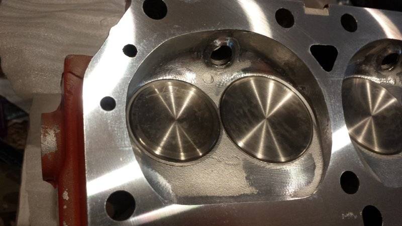

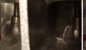

Heads look sweet! Only thing that is giving me pause is the thin iron left around the valve guide inserts.
Don't want to Monday morning quarterback but if I expected to end up with thin material around the guides after porting I would have drilled and reamed for the valve guides then knocked the thin material out of there before driving in the guides and porting. Thin iron makes me nervous. Looks like the intake side too.
I saw that as well. The exhaust guides are cut back to the roof. I figure it is the result of the cnc program and none of the intake guides are cut back. MCH knows waaay more about them than I do.
I saw the exhaust guides cut back to the "roof". Those look great. Exhaust is side is also exposed to much greater temperature swings so that makes sense. Then again a loose chuck of iron in the exhaust probably wont mess up an engine. Intake side, much less temperature swing, but loose pieces will reek havoc.
