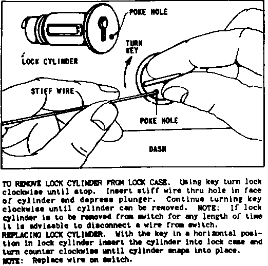

Any tips for replacing ignition switch on 1969 Coronet RT?
Appears this was 1yr only set up.
Sorry Factory Service Manual you can download from MY Mopar.
isn't it just a threaded bezel on the front and a harness plug on the back, shouldn't take 10 minutes
Pretty much none of the aftermarkets are the correct style. Better to find a used or NOS replacement. What's wrong with the one you have?

They are pretty easy to repair as long as the contacts aren’t burnt too bad.
