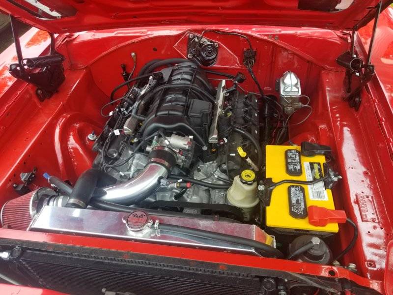

Hello all - longtime lurker since I actually bought my 2 B-Bodies.
Starting a thread here for my 69 Satellite Wagon which will be receiving a G3 Hemi Swap.
I need and want a place to ask questions and track my own progress and in terms of B-Bodies, FBBO definitely has a good, active G3 Hemi swap section.
In May 2014, I flew down to Washington, DC with my best friend and together we drove the car home over the course of the weekend, stopping at junkyards along the way and having a blast. It was a Washington, DC area car for its entire life, and I purchased it from the second owner, who bought it from the original owner's son.
As for specifications, from the factory she was equipped with the following:
318 V8 with Factory A/C
26'' Radiator
Column Shifted A904 3 Speed TorqueFlight Transmission
Factory R6 Red with Black interior.
14'' Steel Wheels with Plymouth Center Caps.
I've done a ton of upgrades and rust repairs to the car since I bought it with the help of friends, which I'll cover at some point.

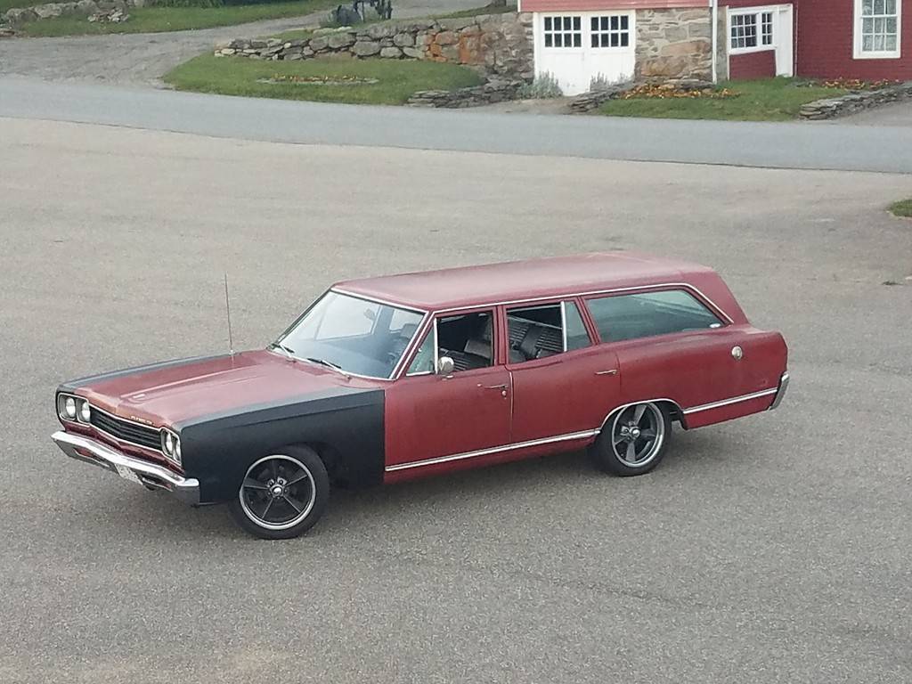

Here it is as it currently sits:
Basically, I've got the car's rust pretty much all fixed (anything else it has left is just cosmetic), made it handle, upgraded the brakes and am upgrading them even more this winter, and am working on redoing the interior to make it comfortable, and the next step is to make it run and drive as well as it handles.
I want to be able to have no excuse not to drive the car.
The wheezy, leaky 318 currently gives me an excuse.

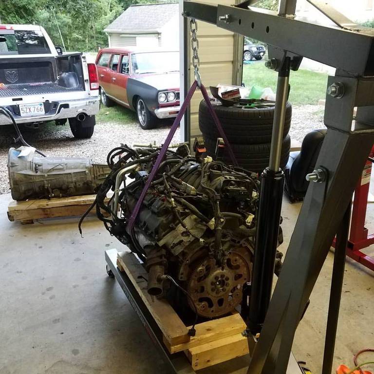

So, a couple of weeks ago I bought the following for my 69 Satellite Wagon:
1) 2013 Ram 5.7 Hemi with 43k (Complete with accessories)
2) 2009 Ram 545RFE RWD with 46k
3) 2010 Ram 5.7 Hemi ECM
4) 2013 Ram 5.7 Hemi Gas Pedal and O2 sensors (from the engine donor)
5) Hotwire Harness and ECM reprogram
Now I'm getting ready to order the other stuff needed to make this swap happen.
I want to get it done over the winter and I want to have the parts collected before too long so I can start before it gets too cold.
So, I thought I'd come on FBBO and ramble on with questions and comments and see if anyone had the time to read what I've written and add their thoughts or experiences.
I'm also doing a lot of reading about Hemi swaps in B-Bodies and E-Bodies to get thoughts on what others have done.
Soon I'll be ordering the Milodon MIL-31000 "Resto Mod" Oil Pan, Milodon 18341 Oil Pickup for 09-16 engines, new oil pickup bolts, a new dipstick, and the TTI Hemi-Swap Engine Mounts.
Planning to have those ordered by next week.
Not sure if I need anything else with that stuff, do people usually buy a new windage tray?
The car needs to have A/C to be enjoyable for the summer, so I am going to probably remove the factory system and use something from Vintage Air. I need to give them a call and discuss my plans. After all, what's another $800-$1000?!
I'm still undecided on what to use for steering components, the car has power steering that works fine as-is, but I think swapping a Borgeson box might be nice from a space-saving and updating perspective. That will only happen if I have the funds available, though.
I've gotta figure out what I want to do for gauges.
That is a bit sticking point for me. I'd prefer not to spend 4 figures on them if I don't have to. Car has the stock gauges right now. Will need to look around and see what others have used.
Gotta work on ordering the new gas tank and an in-tank pump for it.
Wagons use 66-67 B style tanks, and naturally no one makes a tank that is already set up for an in tank pump for one of those.
Will continue posting here as I go and I welcome all thoughts and discussion!
I am also on Facebook, Instagram (@moparrnocar) and Moparts posting about this - sorry if you've seen me ramble about this stuff before!

I did a 2016 5.7 ram hemi swap in my 1969 roadrunner with 545rfe this past spring. I ran into alot of hiccups but over all I am very happy I did it. I love to be able to open the garage turn the key and just drive with no problems. My swap should be just about the same as you are doing. Any questions pm me or ask on here I will try to help with what I learned.

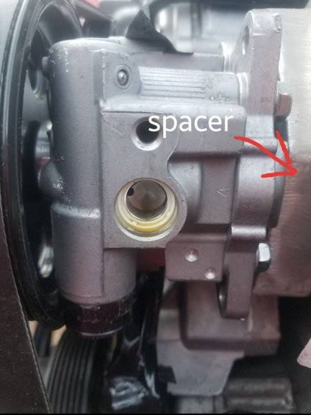

I am interested in what power steering pump you are running there!
How hard was it to get mounted? Reservoir is attached?
The reservoir is attached to the pump.
It depends on the motor you have on mounting the pump to the motor.
1 does your motor have a pump already if no like mine then you need to make a adapter spacer like I did out of a 1-1/4" × 4" x 2" block of aluminium I bought off of Ebay for 15 bucks.
2 if you have a older motor with a pump already there it should bolt on (not 100% sure)
I used a 2016 dodge ram motor switch was a problem because it had the throttle body pointing up not forward so I had no clearance for any type of air intake tube. So I had to change the intake manifold to a 2016 300C manifold but then the timing cover had to be replaced and other stuff to make it work. Like alternator, crank pulley, water pump, heater in and out tubes, ac compressor belt, only thin that I was able to re use was belt tensioner and throttle body. My motor came like this
Had to change it over to something like this

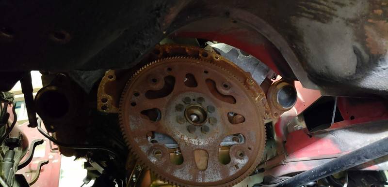

Since this post I've removed the 318, test fit the 5.7 enough to realize that the stock Ram passenger side manifold wouldn't fit and found a Grand Cherokee manifold to replace it with, and bought a Borgeson power steering box.

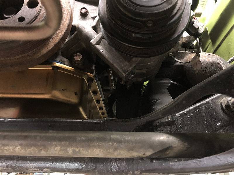

I have the motor in the car sans AC compressor as I'm planning to run without it for now.
Now I'm right at the point where I need to start test fitting the trans so I can cut the floor and the crossmember up.
That is really giving me pause though.

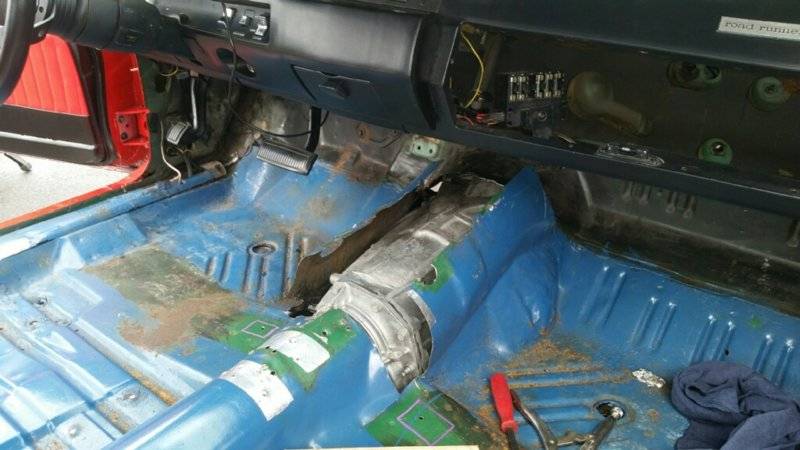

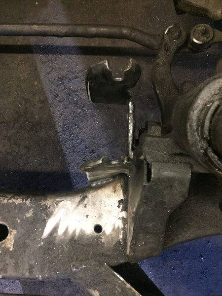

Anyone got photos of their floor/crossmember mods needed for the 545RFE swap?
I couldn't attach the pic to your message.
Heres the video also. Again the video is not me and he is fitting a 4L60E not a rfe transmission. The rfe is bigger. you must cut the floor open .
Your photo is super helpful! That is exactly what I needed to make this happen - someone else who had some kind of a "roadmap" photo for me to use!
Thanks so, so much!
