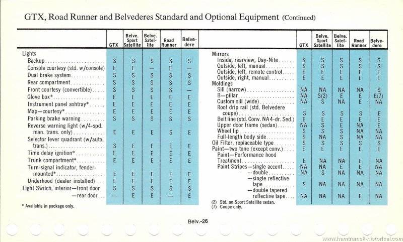

Convertible had them under the dash near the kick panels.

I found my Convertible in the 70's as a survivor and the light harness is part of the convertible top harness. The other 3 harnesses I have seen were also missing any other lights that might have been used for the front floors. All convertible harnesses I have seen did have the trunk light incorporated in them also. Anything is possible, so maybe someone that has seen them will respond.

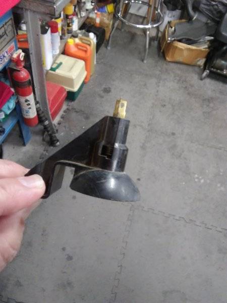

Both my 68 Satellite and the 69 Road Runner I used to have, had them under the dash, right of center slightly. It is a little bell shaped socket fixture with a push and turn bulb that goes in it. The bell shaped fixture is formed perfectly to mount using one screw up under the lip of the dash. I can take a pic tonight when I get home.

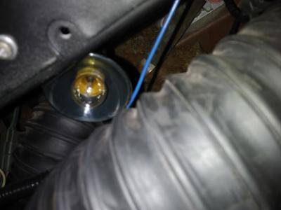

Here is the picture I took of my 68 Satellite convertible. It is located under the dash in line with the ash tray. My 69 Road Runner convertible had it in the same location. I have an extra light fixture so I took a picture of it so you could see what it looked like not installed.
Here is the picture I took of my 68 Satellite convertible. It is located under the dash in line with the ash tray. My 69 Road Runner convertible had it in the same location. I have an extra light fixture so I took a picture of it so you could see what it looked like not installed.View attachment 1408446View attachment 1408447
awesome thanks so much that is exactly what i have.
Is this just a single one in the middle? I don't remember seeing it in the schematic.
yes it is a single light mounted pretty much under the center of the dash. Lights up the floor board pretty good.
