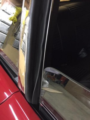

I'm having trouble getting my roof rail weatherstrip to fit properly. I'm using metro moulded parts.
Does anyone have another brand recommendation that worked well for them?

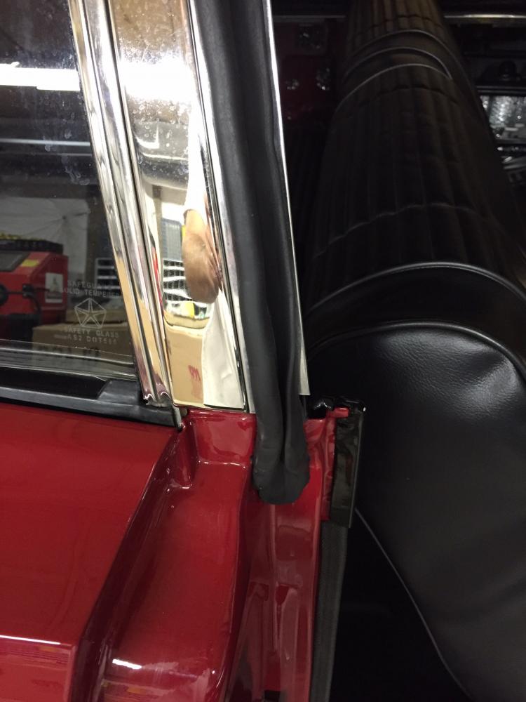

Mine has an issue near the bottom of the post. It stays folded over and the window goes behind it when rolling it up.
Mystery solved.

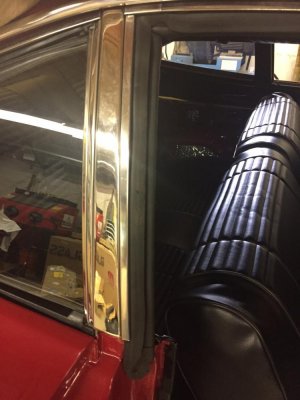

Apparently I had a sent that were moulded incorrectly. They sent another set and they fill really good.
I was a little surprised as Metro Moulded usually has a great fit. I used them for my 68 and fit like a glove. Glad you got it worked out.
I tried but the lengths, of the door end v post end wouldn't work.

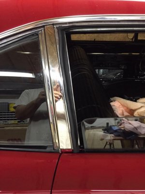

New one looks good so I'm happy
Yeah. I was surprised. Love mine. Fits like a glove. Glad your happy now.
Just curious. Is the bottom of your post weatherstripping where it drops into the door jamb glued or screwed? Just got a 69 super bee post car and installed weatherstrip but no holes.
