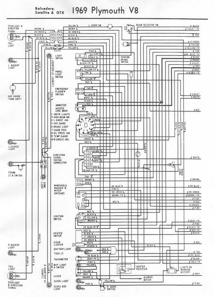

I was putting the dash back together and hooked up the wiper switch. I went to test it and got a shock and smoke. What the hell, it was working before. I tuned it off and found the pink wire melted a little. I have a brand new dash harness so I don't know whats going on. Could it be a bad switch, it was working before. Anyone have a clue? Thanks!

that is part of ground,gauges mounted. Rallye or standard gauges? Why new circuit board? pink could be glove box light,headlight switch,a pic would help.
that is part of ground,gauges mounted. Rallye or standard gauges? Why new circuit board? pink could be glove box light,headlight switch,a pic would help. View attachment 788424
regular gauges, looks like the pink wire goes to the flasher from the wiper switch. New circuit board because half of the lights and the temp gauge didn't work.
I would think flasher wire would be constant power,did a wire get nicked? How about unplug wiper switch and see if all works. If so I would think the switch is bad.

Yes turn signals. They worked before this and they work now. They did not work when wiper switch was hooked up. I am thinking that the pink wire may have got nicked like you said pushing the switch into the frame, it is at the top near the frame.

I have a colored wire diagram and the top of the switch where the pink wire is goes to the flasher. then the red wire from the flasher goes to the directional signal switch connector, whatever that is.
According me the pink wire from the 3-speed wiper switch is incoming 12V.
If you follow the schematics it is tied into a black wire that leads to the fuse box.
You mentioned that at the time the switch was hooked up the flashers did not work, which is fed by the same feed/fuse.
Could be indeed your switch is bad and making a short.
Hmm, you are correct. I think it may be a bad switch too, I ordered one for a hefty freegan $198! I also saw evidence of me scuffing the pink wire while trying to push the switch into the frame, I had to put black tape on it. I wonder why the fuse didn't blow?

I know there are several fuses that have a metal link between them on the input side to i believe share 12V supply.
If you would connect the wire of that particular circuit on the wrong side of the fuse it always will have 12 volt and is not protected by a fuse.
Have a good look at your fuse box first, disconnect battery and check that the supply to that black wire (where the pink ones ties off on) is installed correctly and that the fuse amperage rating is correct.
Saves from being struck again and prevent a potential melt down somewhere of worse case scenario a fire.
