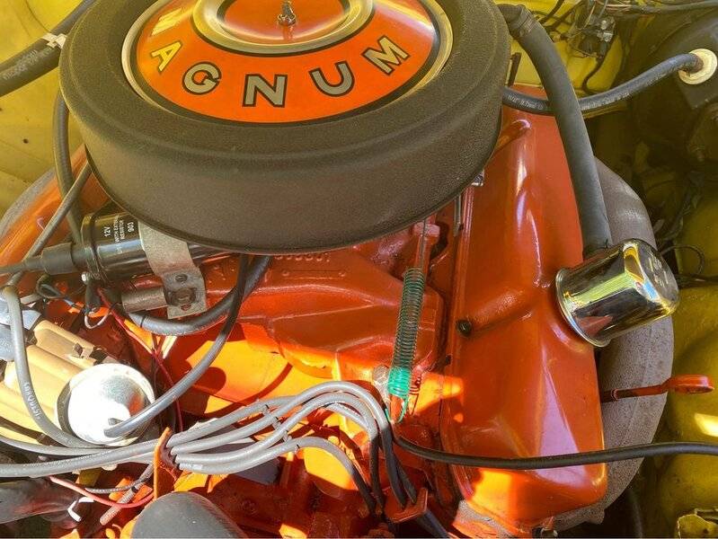

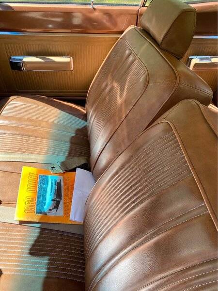

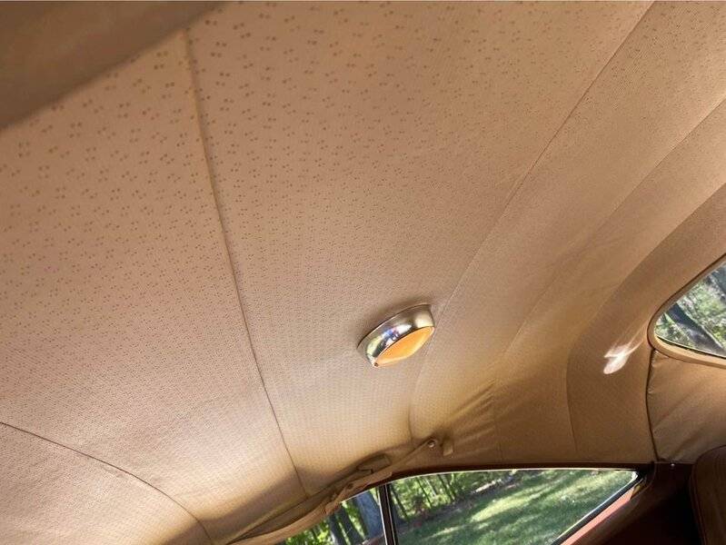

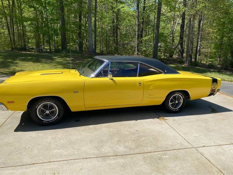

Can someone tell me what the stock carb would be on a 1969 Dodge Super Bee with 383 engine?I am looking at this car for purchase.It is 86,000 mile car seems pretty nice.Other than color change every thing is original with a build sheet.Plan on driving car this week.Here are a few photos and let me know if anything STANDS out!
142238817_1471138833090016_5486168564064018507_o.jpg 142290545_1471139016423331_6467903611969114766_o.jpg 142378085_1471138959756670_8192532140927248193_o.jpg 142378085_1471138983090001_7867108665427454533_o.jpg 142622901_1471138946423338_1224525658818895019_o.jpg 143209442_1471138886423344_6268601474140288484_o.jpg 143476094_1471139043089995_4191512088196310475_o.jpg IMG_2045.jpg FENDER TAG 2.jpg
Original would be carter AVS.
I wouldn't base any buying decision on what carb it has.
So was it originally turbine bronze?
And they changed it to yellow?
Wow gotta disagree with that decision.

No,it was a cream color Y3 unless they goffed up.Would this be possible.Owner says you can not tell color was changed?
Y-3 = Cream. The paint chip chart makes it look like a boring sand color. I'm not one for changing colors, cuz I'm a purist. Looks like a decent car, but, one needs to really inspect it to determine that for sure.
4682S should be the correct AVS carb number for an auto trans (383) Super Bee in '69. As stated earlier, don't let the carb sway your decision.
That color is awful! Why are so many cars painted this puke color? School bus yellow Doesn’t cut it. It’s nothing close to the Y3.
it looks good other than that.

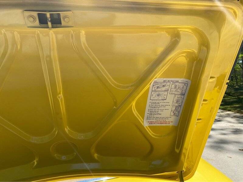

I like it and if the price is right go for it. solid?All the numbers match? Also factory would slap that jack decal on it would not be that perfect :lol:
The yellow appears to be a 1970 colour. Personally, I am a fan of 1969 Sunfire Yellow. This was the colour of the new Superbee that bought in 1969. It looks like a solid, complete car.

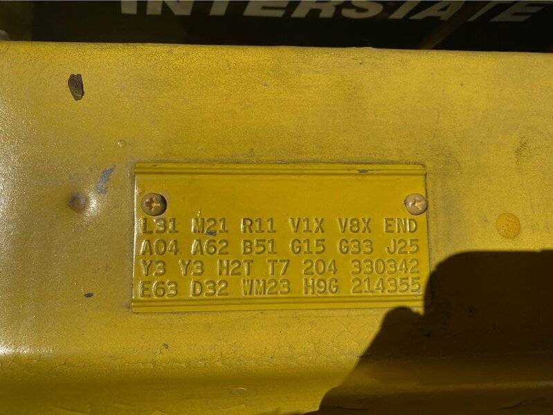

if your gonnaa use a repop fender tag, you might want the paint code to match the color of the car

I believe the correct carb would be a #4682S (Carter AVS)

Doing some amateur sleuthing here....
That car is shown on the Super Bee Registry website, indicating the following:
WM23H9G214355
204 D32 330342 Y3 H2T T7 V1X V8X
A04, A62, B51, G15, G33, J25, L31, M21, R11
Comparing to the presented tag (agree, that appears to be a repro):
Yep, somebody at some point registered the car on the Registry as represented on the tag for sure...
http://www.superbeeregistry.com/
Good sleuthing.
This its a remade tag.
Further, I'm finding all sorts of old "listings" for this car (some of them over 5 years old)
on some of the more nefarious websites out there....
Hey @GTXMopar - have you actually laid hands on this car in person??

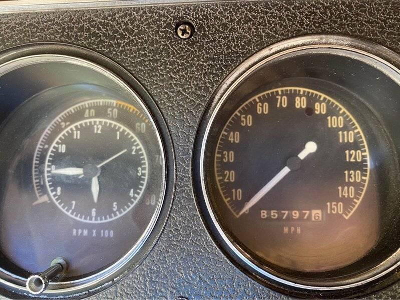

When I bought my new Superbee in 1969, it did not have the tach either. The dealership offered to install it for the option price. The car also arrived as a "radio delete" car. This dealership said than whenever they ordered a "hot car" (their term), they did not order them with a radio, so that purchaser could have aerial placed at his choosing. I paid the AM radio option price and specified a rear deck aerial. Obviously, none of this would show up on VIN tag.
No,I have not looked at car in person.For some reason you guys are telling me a lot of things are not adding up correctly?
