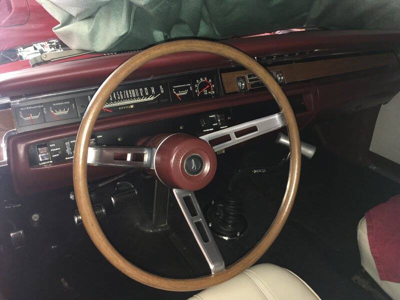

Well I finally found the GTX hockey stick and the drivers side piece. I'm likely going to have to clear all 3 pieces for a uniform finish. So what part flakes off the black? I can redo the black and just clear all 3 parts?
I bought the set for my Bee and the black paint would rub off,I thing the used water paint LOL I redid my wood grain on my original dash plates..
I have polished the fronts with a series of wet sand paper, like starting with 400 grit. Then up to 1500, 2000 or higher. Lastly use the plastic headlight polishing compound, a drill and those buffing wheels. Mine turned out great
Finally pieced it all together and did order the aftermarket radio bezel. The match speaks for itself. Real happy. Still need to buff the OEM stuff including the astronomically expensive hockey stick. Source: Vans Auto, eBay and Mo-Par Restos who lives completely off the grid!
