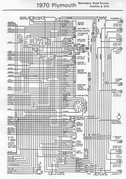

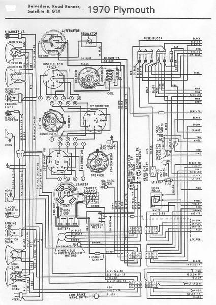

Start with these.. Helps a bunch. And here is the downloadable Shop manual. HERE
Thanks i got one of these already laminated and posted in my garage. There was no way i would have paid them that much. They turned me off on that alone. i was always thinking that it would costs $1,000 to $1,500... maybe from old posts here.
