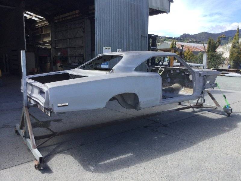

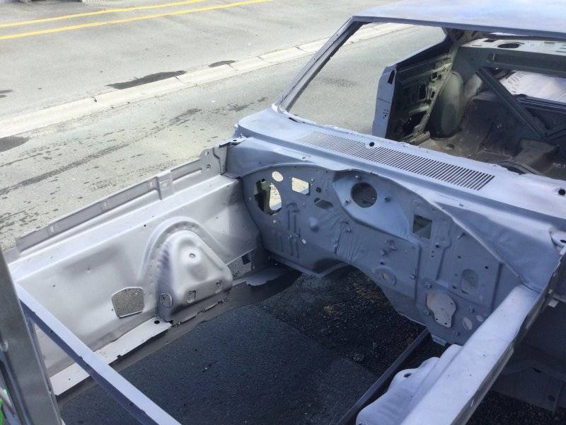

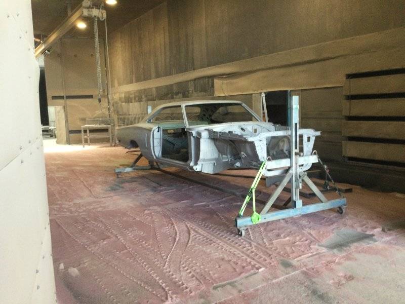

The body got media blasted yesterday. Cleaned up great and no new damage.

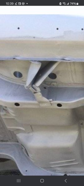

We rolled it 300 yards to the body guys shop. I will call in once a week for progress photos. He might do 2 days each week on it. He will fix up the trunk floor to start with. It has a 2 piece replacement that wasn’t plug welded correctly and the 2 halves are not lined up correctly. He may remove 1 half. Not an easy job.

The body is at the bodyguy. I popped in yesterday. He has removed the replacement trunk floor due to the poor attempt the previous bodyguy did. Poor welding, alignment and was over top of the old floor in places.
Do it once and do it right.
