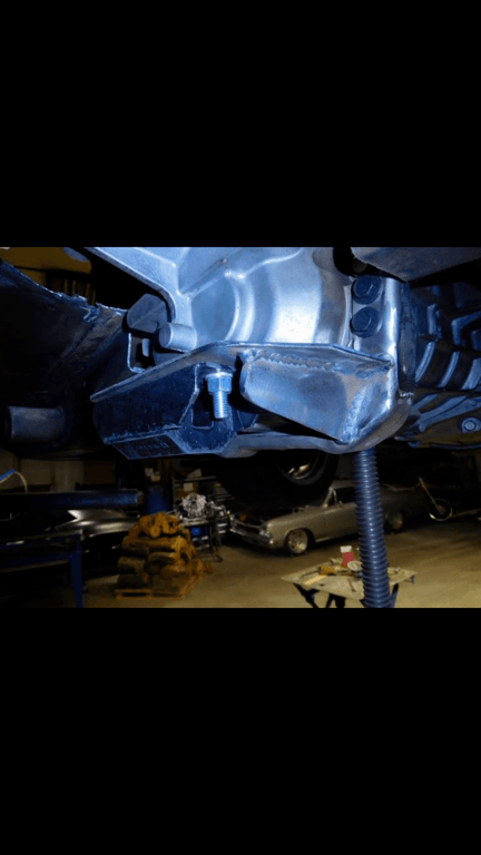

Can I get some help needing pics of transmission crossmemember for a 6.1 hemi swap
into 70 superbee any and all pic appreciated. Also trying to eliminate linkage and go to
toploader any info helpful and pics much thanks to any help.
What kind of transmission are you using?
Tremec 6060 with 6 speed. Have a few ideas put togeather any other info would be helpful.

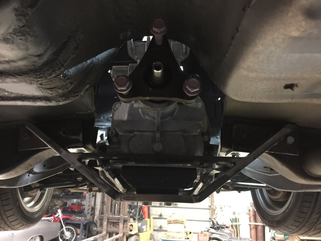

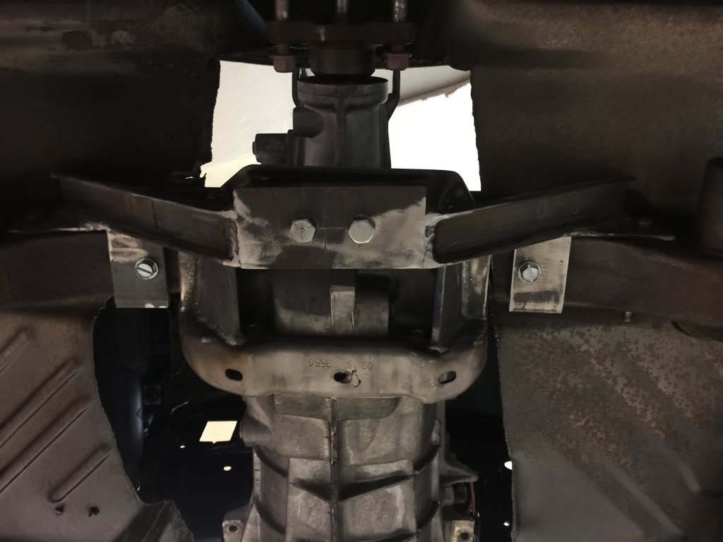

We are in the middle of fabricating our own transmission support for the b and turning out really well. We were concerned about the transmission being to low will have few more pics as we progress.

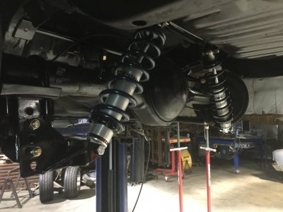

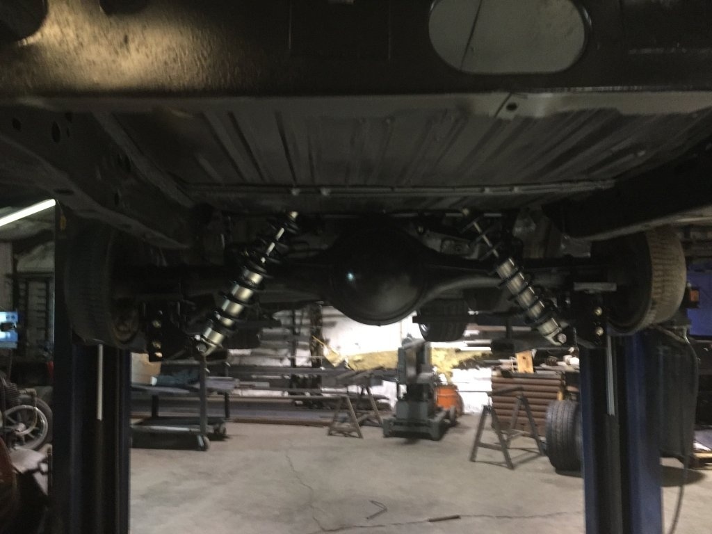

Talked to a few people and have seen some posts in the past concerning the correct degree of tailshaft and correct degree of pinion. This car is equipped with ride rech suspension and we can adjust the pinion up or down no problem. My question to everybody is the correct number of degrees? If i have 2 degrees on the tailshaft and 2 degrees on the pinion i feel im good. Have read some posts and saw 3 degrees was a popular number and agree if your 3&3 your good how bout 2&2? As long as both are the same?

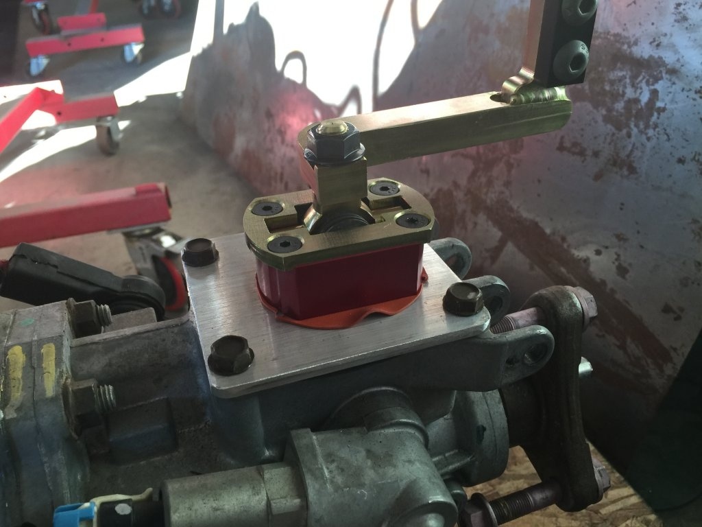

Thanks to usa roadrunner way back issue with dumping linkage and finding the right top loader with some modification resolved!

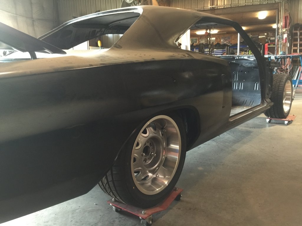

I bought the wheels at mopar nationals from year one.They are 17x9 and they are a knock off of the original rally wheel dodge put on in 70. That pic not showing the center cap just havent put them on yet.
I love the way they look! I think those are going on my "want to buy" list. Thank you for the info.
Here is what we came up with on the tr 6060 not quite complete but looking really good.
Here is a pretty good pic looking straight up from the bottom. We have 3 degrees on the tailshaft and looking good.
