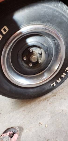

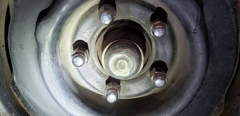

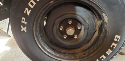

Hey guys, I wanted to see if there was any info on the wheels that are on my gtx, they are 15" but I'm not sure of the width, there's an H, E, M34, and a13 stamped between the lugs and by the valve stem reads m34 10, they also have beauty rings on them which I thought was unusual. Are these six pack or hemi wheels? The two front rims markings match each other but they differ from the markings on the rear wheels except for the H stamping. Anyone know what these wheels are from? Thanks!

Looks to me like you have a 15 x 7 or a 15 x 6.5 steel wheel , with a 15 x 7 or 15 x 6.5 ralley wheel trim ring. If it's a 15 x 7 , those rings are worth some good money.
The H probably stands for heavy duty , I have seen some of those.

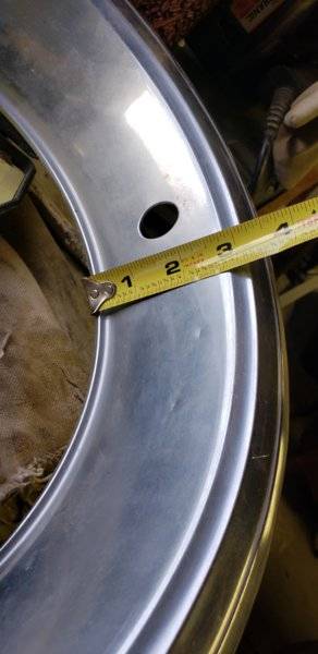

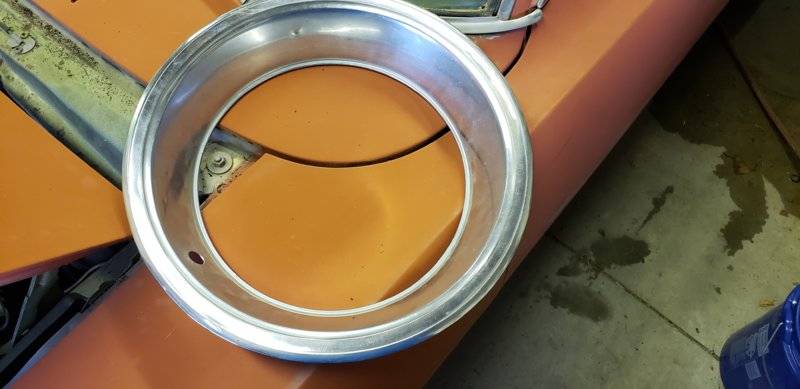

Can anyone tell if these are the 15x7 rally trim ring? I cant find any part numbers or markings on the backside.
