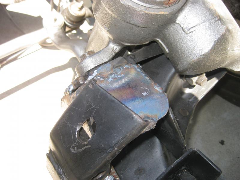

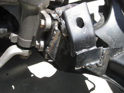

Holy crap DVW! I should have done what you did, but.... I like many others, backed out. Well sorta. I ended up keeping the later K-member, but moving the perches forward. So, the engine sits in it's stock location, but I get the added benefits of better idler bracket and sway bar setup.
