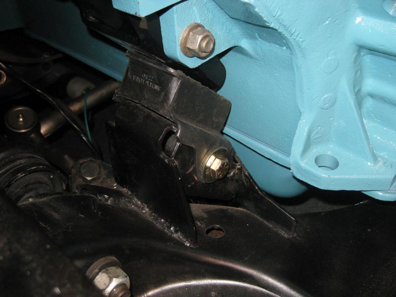

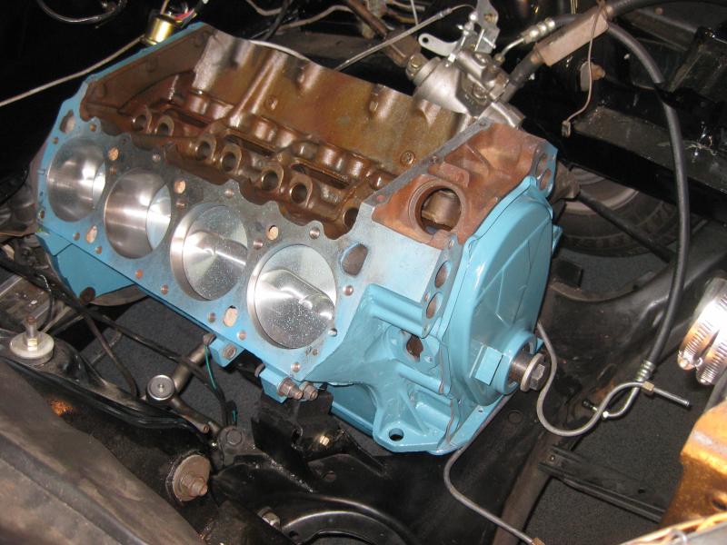

I've been planning this project for years. It's FINALLY taking shape. I have a 1964 Polara 500 with the original 383 and a 1967 727 transmission. The K-member is from a 1970 B-body. I've read this swap will move the engine back 1 5/8", but it looks more like just 1". Better handling, braking, sway bar set up, etc.

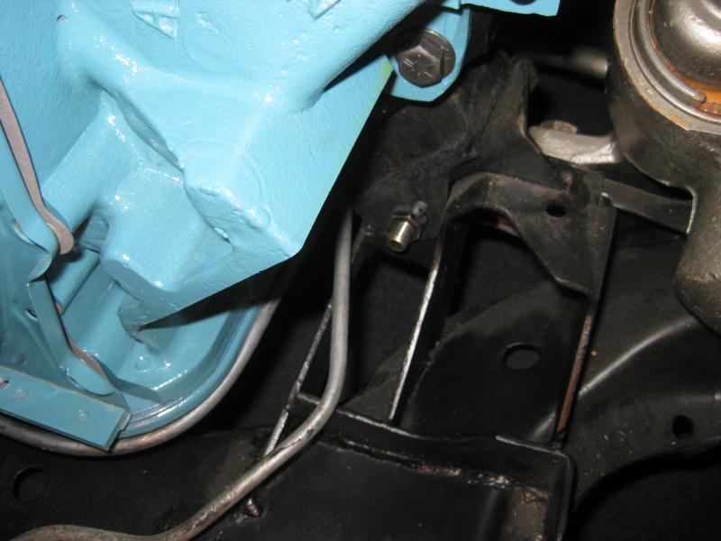

I have the K-member in the car, and just dropped in the fresh short block. The first issue to be addressed is the transmission cross member support. I didn't think to get the cross member from the car that donated the K-member, so I hope someone can post a photo of one so I can see if it may work. As you can see in the photos, the original cross member will not work.

I have one of those conversion mounts. It worked well when I had the stock K-member in. Now I need a complete cross member. No conversion mount will solve the problem. See the last photo.
Turn it around?
Well now I'm leaning towards the cut off wheel and welder.

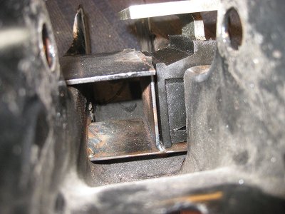

hi,all i did to mine was turn it around and re boxed the the mount area.less than a hour of work,mark

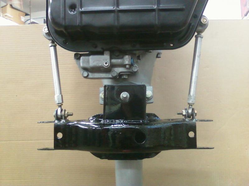

Just cut the bracket off and fab your own. A piece of 3/16" flat stock with ears bent at a 90 degree angle to the bottom works. mount forward or rearward as nec. If you're using a push button Trans the Chevy S-10 mount needs the ears opened up a tad to fit. Disregard the heims as they are to keep the motor plate from moving for and aft.
Doug

Thanks DVW. Yours looks similar to what I did with mine. Actually a friend does my fab work. I will try to get photos posted this evening. I like the Heim Joint supports. I never thought there was much movement there, but I guess so.
CBCBORM, I have TTI exhause with slip fit connections. I assume this will make things easy, but haven't actually gotten to this point yet.

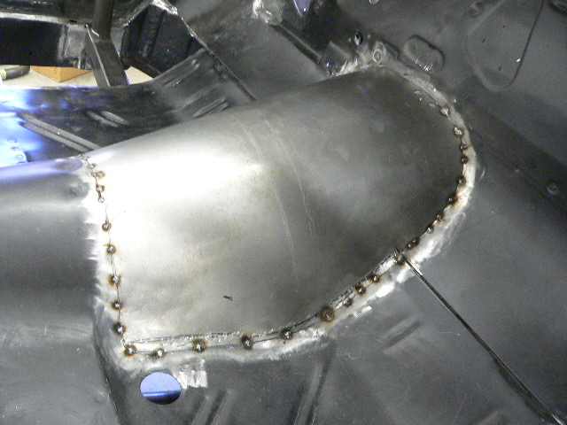

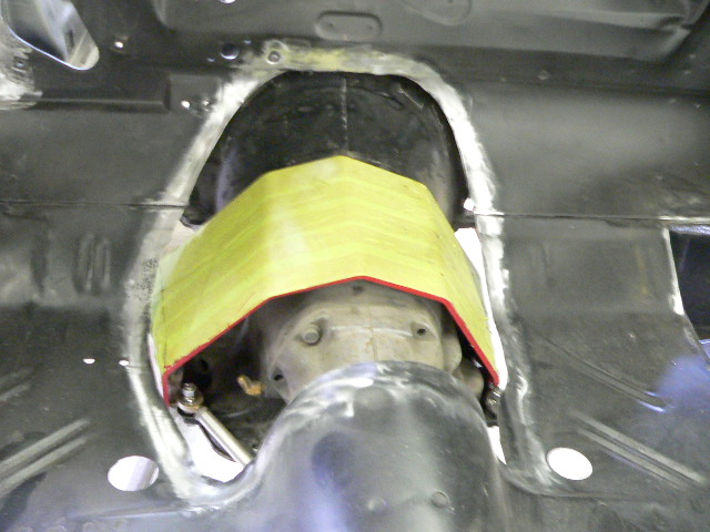

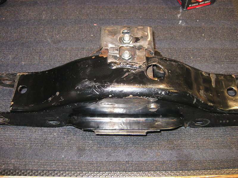

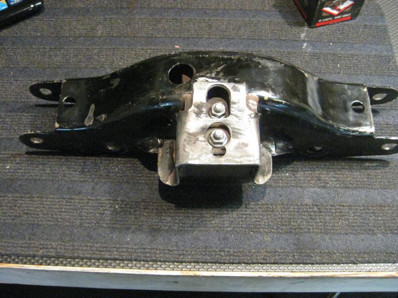

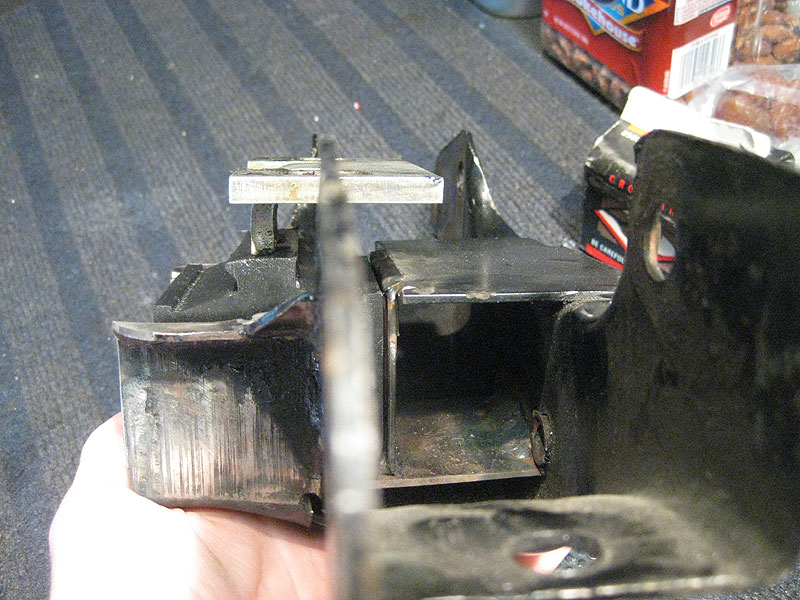

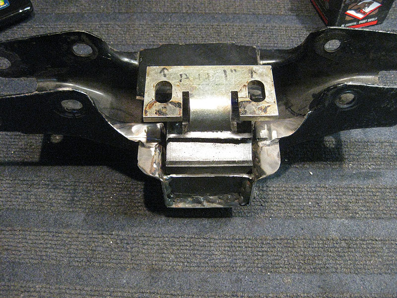

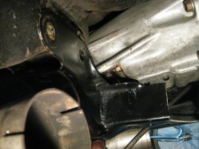

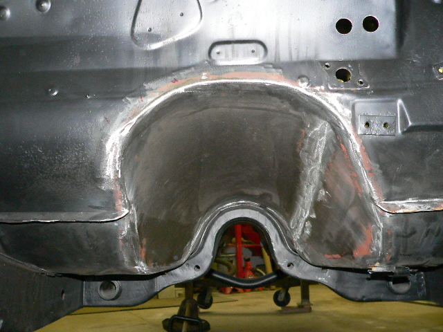

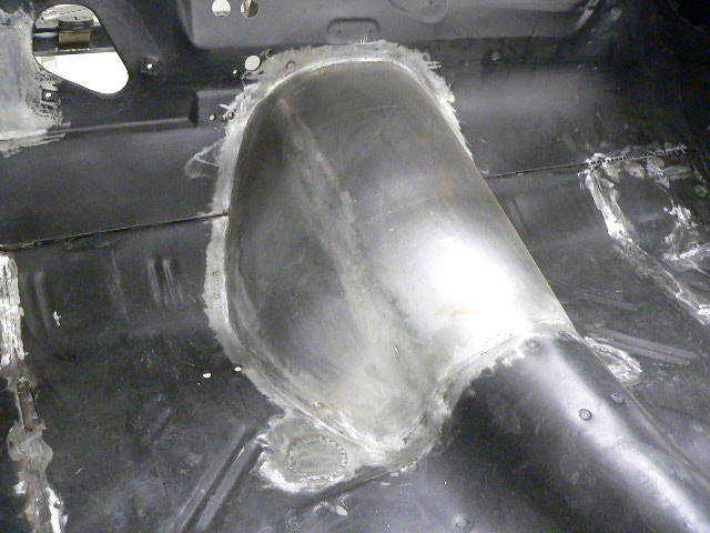

I'm sorry I move sooooo slow on this. Anyhow finally working on the car again today. Here is the modified cross member.

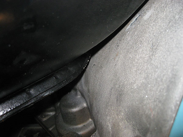

A new problem is the firewall pinch weld. He sticks down too far. The trans bell is not able to go up far enough into the tunnel because it's crashing into the pinch weld. I had to dice the pinch and fold it back.

Looks good. That's right along the same lines that I did on my trans crossover/mount.
64 Ply Sport Fury with a 69 440/67 727 shoved in the hole. I've only had the chance to mock set mine in, just to get the measurement for the trans mount. I had a spare 64 crossover that had shaky welds on the box anyway, so I re-fitted it, moving the mount as needed. But, I'm also using the stock 64 K-frame with it all.

I don't believe it will bolt to the body of the early B cars. I'm past that part now though. Right now I'm getting ready to cut the firewall so the trans bell will have room to go further back in the car. Chop Chop!
It will go in w/o the cut. But making the tunnel big will allow a shield and easy access.
Doug
