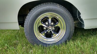

I put Cooper Cobra tires on Wheel Vintiques Ralleye Wheels ; fronts 235/60-15 on 15x7 rims,
rears 255/60-15 on 15x8 rims. This went on my 70 Satellite droptop (same car as 70 GTX) so fitment is fine. Changed the whole feel and handling of the car and gave it a better look/stance. Got the rims from Summit, tires from DiscountTireDirect. Best prices I found.
What trim rings are you using on the 15 x 8 wheels?
