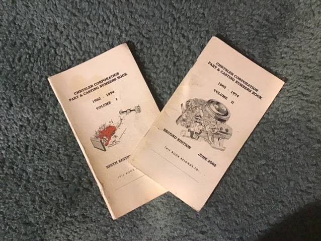

the assembly codes are found in the PART & CASTING NUMBER books

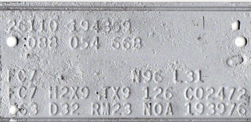

i got lucky and found them on EBay. If you send me a pic of the fender tag I can decode it for you. Lynch Road tags are difficult and provide very little information. I've seen Lynch Road tags with N96 listed on them.
