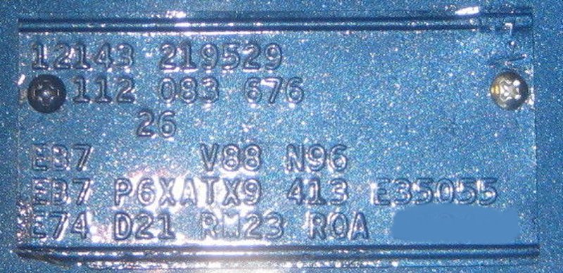

Trying to figure out what the following numbers in the fender translate to
It is a Lynch Road Tag
second line from the Top & starts right next to the the left screw
112 083 676
The first 3 numbers relate to the engine , but what engine?
The second 3 numbers relate to the Axle, but what axle?
And the last 3 numbers relate to the Trans, But what trans?
anybody know the answers?
Thanks Larry
112 = Hemi four speed engine assembly
083 = rear axle assembly = 9.75 Dana with 3.54 SG; 10" brakes
676 = Hemi four speed

Well, the vin and the rest of the fender tag should tell a lot of the story, the lynch road tags dont give a ton of info, but enough. If the driveline is in the car that would be a nice car, no matter the condition..
If that car is a post car there was under 40 426/4's and if its a hard top there was under 100, only 20 or so that went to canada combined between posts and non, auto and manual... So depending on the options it could be a 1 of under 5 car pretty easily...
lots of info here.. for the fender tags, also another tool on the web for decoding the rest, but the rest is easy, its going to be color (EXT upper and lower or vinyl, INT style and color) and then a few options, like c16 (console), n96 (fresh air), 26 (26" radiator), etc..

Here is the rest of the fender tag
Code
Description
E74
426 Two-4 Barrel Hemi
D21
Heavy Duty 4-Speed Manual Transmission
RM23
R = Plymouth Road Runner
M = Medium
23 = 2 Door Hardtop
ROA
R = 426 HEMI 425HP 2-4BBL 8 CYL
0 = 1970
A = Lynch Road, MI, USA
Sequence Number '######
EB7
Paint Code: Medium Blue Metallic / Jamaica Blue Irid
P6XA
Trim Grade/Style/Color
P = Premium
6 = Vinyl Bucket Seats
X = Black
TX9
Upper Door Frame: Black / Black Velvet
413
Date Built: 4 / 13 / 1970
E35055
Order Number: E35055
EB7
Roof Type OR Color: Medium Blue Metallic / Jamaica Blue Irid
V88
Delete Transverse R/T Stripe
N96
Fresh Air Hood
26
26 in. Radiator
112
083
676
Hemi four speed

1970 Road Runner Hemi 1 of 59 for sale on ebay
It's not even that. This is an export car (E in the VON) and would not be counted in the 59 cars sold in the US. Export numbers would be much lower.
FWIW...I have another Hemi four speed RR in EB7 on file so there are at least two.
Seventy
The car now has P/S P/B & Rally Dash but these do not show on the fender tag
Could these have been on the car but not the fender tag?
Seventy
Yes. The car could have options that are not coded on the tag.
RE Export code: the car could have been ordered by, say, a serviceman overseas that was coming home and wanted the car available when he arrived. It could have been ordered through an authorized seller while he was in SE Asia or Europe. Technically, the car could be considered 'built for Export' as the order came from overseas but the car actually never left US soil. It could have been shipped to the hometown dealer. That happened a lot at that time.
It would not be a problem to register the car in the US.
