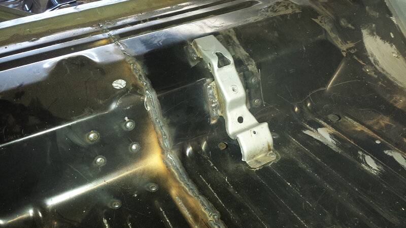

I just purchased a 1970 Road Runner that the trunk floor was completely rusted out. I have purchased a AMD 1-piece trunk floor and need the locations of where to locate the J-bolt reinforcement plates. Thank you
This is from my 69 GTX. It may get you close as I believe the pans and gas tank are the same.
Thanks for your help. All I need now are the dimensions underneath from each wheelhouse over to the center of the bracket and the dimension in between the brackets.
When I reinstalled mine, i put the tank in place with the two straps and lined the brackets up from there.
