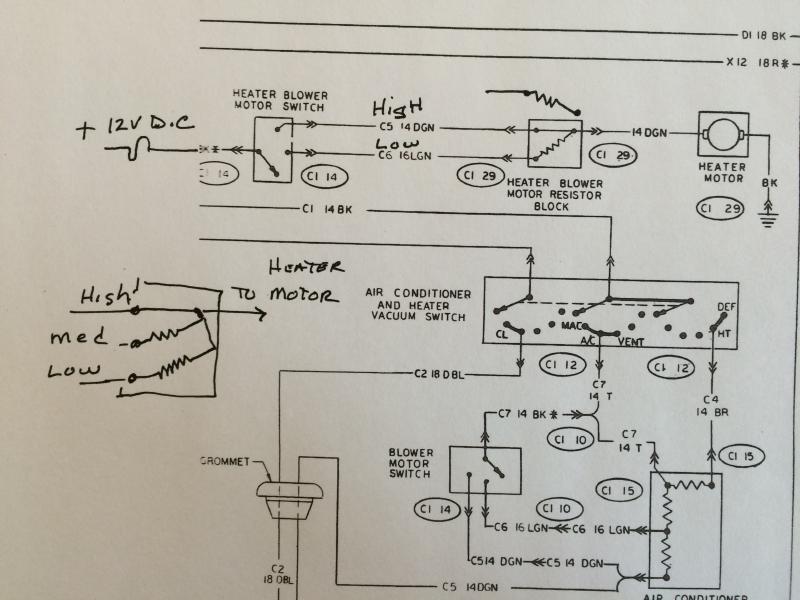

Heater block is a resistive device. Multiple inputs with a single output. If your heater switch has two or three positions the resistance block with have two or three inputs with one out. Using a dc meter check the inputs to the block as you move the switch from off to low-med-high. Voltage will identify the corresponding input. The output from the block with feed the motor. Not sure this helps but its a start
Thanks that is a perfect start

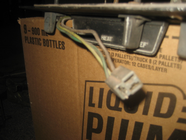

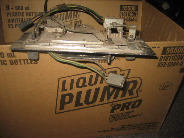

69/70 Dedforst unit, no air
Does your existing plug connector look like this? The triple goes to the resistor & the single black ,at the back goes to the motor.
