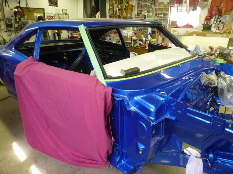

Hello all ,wondering what brand windshield gasket to buy? Car is a 70 Roadrunner post car have a decent used windshield, I had a hard time on my 68 Roadrunner getting the mouldings to catch the clips think that gasket was a
Percussion gasket,any suggestions?

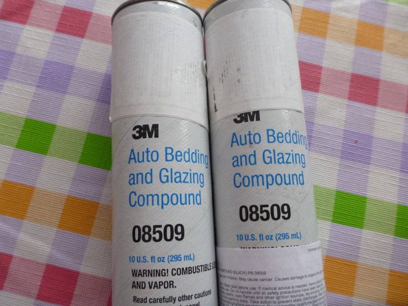

Precision... get it out of the bag and on the pinch weld for a few days or more before you attempt the install. Don't forget to seal the gasket bottom face and pinch weld with butyl as outlined in the FSM.
